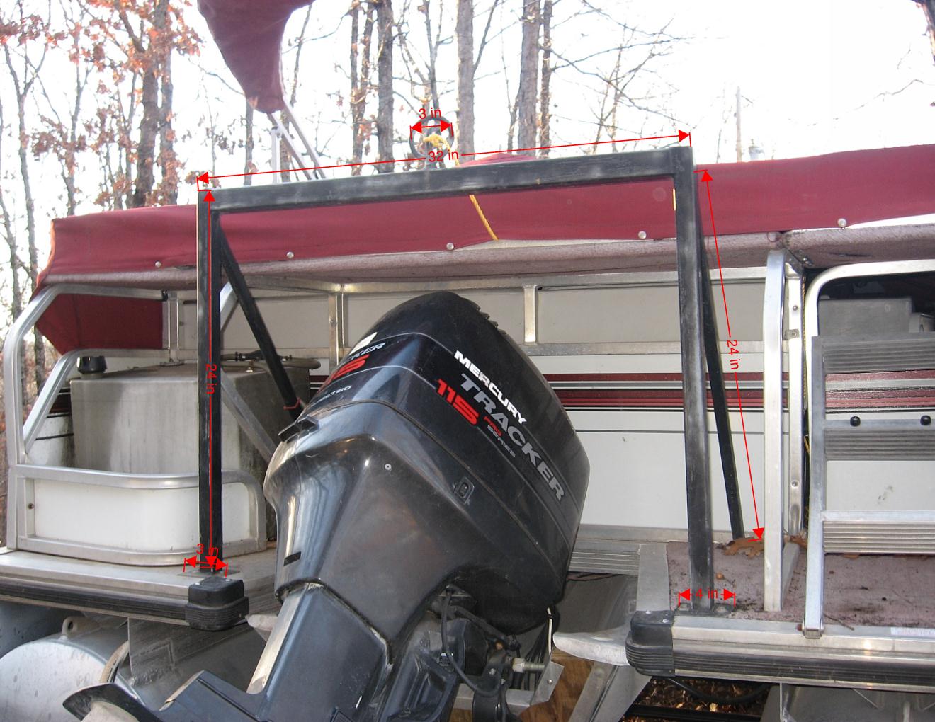

#5 Post by curtiscapk » Tue Aug 09, 2022 4:57 am
not sure why that wouldn't work? I've used a homemade one for 14 years!

I've got a Turbo Swing and love it. I had my dealer remove the one that looked like the one on Rick's Qwest because it supposedly wasn't rated for tubing, and I tend to opt on the side of overkill if I have a doubt. Apparently tubing can put many more pounds of stress than skiing or wake boarding.
But I see boats all the time using a setup like Rick has for towing tubes. However, about a month ago I saw a brand new looking Tritoon in our marina with that setup and it was completely ripped out of the deck in all but one of the mounting points, so maybe it really can be a problem.

When I took delivery of my toon, I went to a local metal fab shop and bought 4 ea. 6 X 6 X 1/2” aluminum plates to put under the deck where my tow bar attaches to the deck. It’s been fine for 7 years so far.

Normal towing around with a tube is no issue for any tow mount, but the tube can put a massive load if it submerges under water. Like stop the boat in 6ft.
Big backing plates and an observant operator can mitigate the risk.
