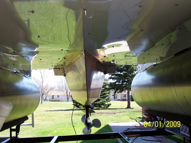

I did mine this past spring...
I think the only thing I did different then most is I had the ends bent at 90 deg with a 4" drop to cover the side brackets that go from floor to toons.
Cost 450.00 and did myself, very easy....
The best thing that came from it was the ride, very smooth.....
No more feeling like someone tapping on the brakes... haha

jim454
Posts: 358
Joined: Thu May 07, 2009 8:30 pm
Location: The upper Mississippi
Re: Underdeck"skin"

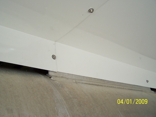

#6 Post by jim454 » Wed Sep 23, 2009 6:15 am
Nice job jr,
Do you think you would notice much of a difference if you would of ran the ends straight to the tubes? (I noticed a little gap there)

jrboatin
Posts: 30
Joined: Mon Nov 10, 2008 1:30 pm
Location: Crown Point Indiana
Re: Underdeck"skin"
#7 Post by jrboatin » Wed Sep 23, 2009 9:58 am
I love the ride.
No I do not have lifting strakes on my boat.
I am not sure about a difference if I have ran it another 1/2 ", I just dropped it down 4" because I did not want to have to cut if it did not fit right.

#8 Post by jeffybear » Wed Sep 23, 2009 2:36 pm
JR, looks great. I too would like to do this to mine. What thickness is the underskinning??

#9 Post by jrboatin » Wed Sep 23, 2009 4:00 pm
I believe its standard .060 . I was going to do .040 but for $70.00 more I went with the thicker one. Also its white on the one side, they
called it PVC coating, gave it to me for free cause it was extra Alum laying around. Got it from a Fab company out of South Bend Indiana
