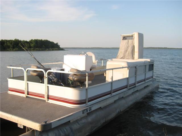

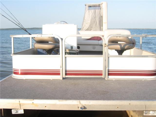

My toon is a conglomeration of several I think. The pontoons came from a 1986 aqua-patio. all new decking and carpet with the furniture coming out of a 1990's model but have no idea. The fencing i could not begin to tell you where it came from..lol...its sounds hodge podge but it really does look pretty good, I think.
Never would have thought to link it to the actual furniture and I will have to look into that as a possibility. I'm thinking im gonna have to take it all down and start over from scratch as far as getting it sturdy enough to carry and hold a bimini.

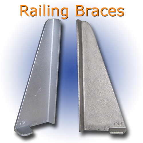

I would recomend there on both sides of the gate inside a stainless steel triangle 6" to 8 inches tall and comming out to the floor 4" to 5". bolted stainless no screws. If that is not clear maybe i can get some pic's. Thanks for your pic's

Those above are ok but if you have a good aluminum welder I recommend a D brace made from sq al tubing, bent and welded. I had them on my old Sundancer and right at front gate where everyone grabbed when coming aboard in the 10 years we owned it the railing was as tight as new. I would put them on each side of each gate.
