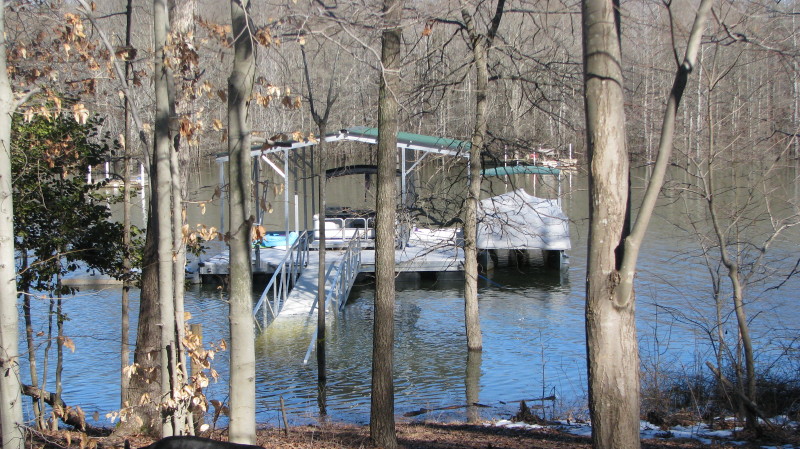

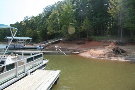

Pictures of your dock would help! But, if it fluctuates that much I don't know of a safe sure way to handle it. I have a floating dock and have problems when the darn Corp of Engineers lets the water up and down that much and more. I do have friends who live there 24/7 and keep an eye on things, but even that's not 100%. The water went up 5 ft and our dock was up in the woods. We had the boat out and safe at the time. Then they let it down 3 ft in a week and out dock ended up on top of one of our dock tie posts. We had to cut the post off and push and pry our dock back in to the water. Another thing is how your land slopes or if you have a bank to waters edge. If you have a gentle slope down to the water it's nice, but the worst type to deal with your fixed or floating dock. If you have a nice bank of say four or five feet above waters edge then a floating dock with a long walk way anchored to a post on shore works best, but is expensive. A picture of a neighbors dock below shows it when water was normal. Next one shows water up 5 ft!
