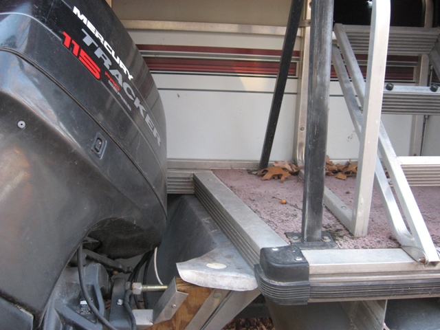

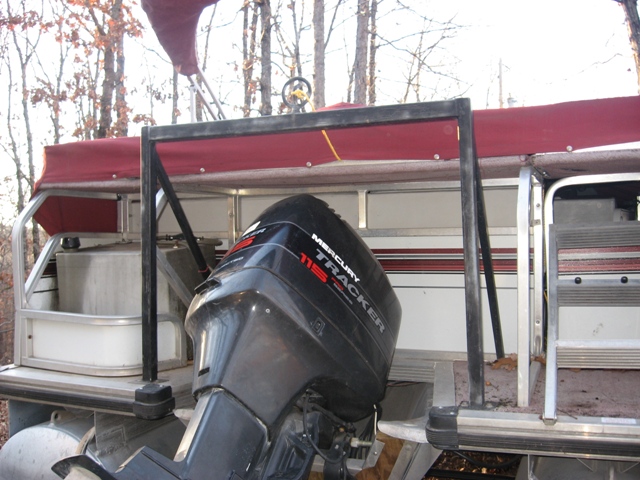

Mine is an older tracker but here are some pics. Already on it when I got it.
Everyone thinks it should be turned the other way but it works great for us.

Thanks for the pick but i have no decking there at all thats why im stuck on were to mount at

curtis, is that made out of steel? how heavy is it and how in the world do you keep it from rusting?
ive been toying with mabey welding up one since I dont really have anything sturdy enough to tow anything with.
trott, if you can bolt whatever you make to any under deck cross members you should be ok

Yes I believe it is steel. Don't know how heavy it was already on there. I haven't done a thing to it in going on my second year. I haven't looked for rust but there my be alittle on top after looking at last pics from Labor Day.

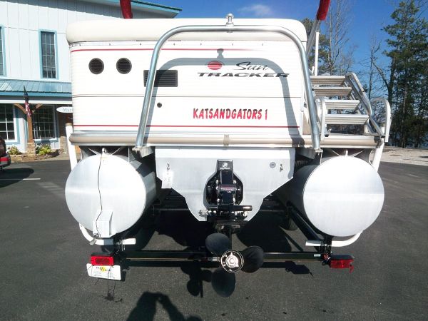

With alot of serching i have found a pic of the tracker oem skitow I personally will base what i build off of that most likely customize one for another type of boat to fit mine. Simply makeing mounting brackets This type of customize is not foreign to me and I personally would not endanger my children I do thank you for the concern floter dino if you are wanting to add something to you boat i have called a tracker dealer and the oem is $460 here is a pic it is on an i/o but should work the same on an o/b
