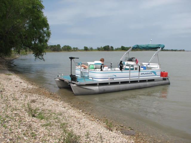

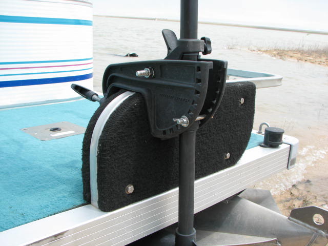

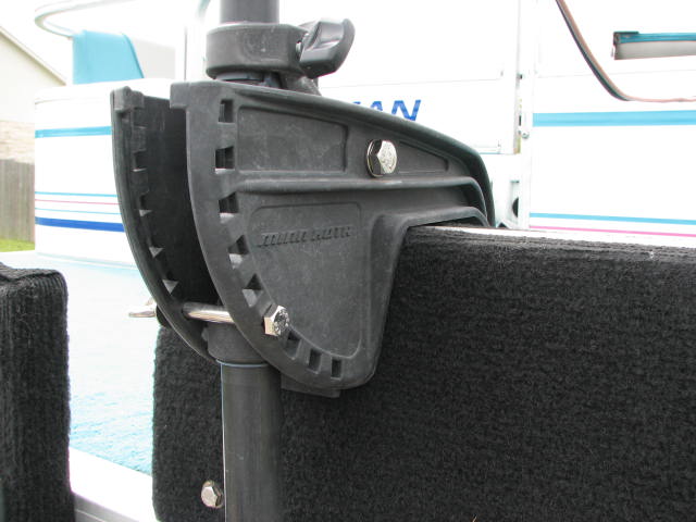

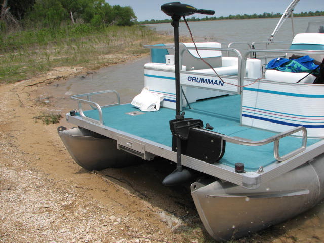

I'm not sure how "budget" you want to go, but here is what i did. It is a Minn Kota Endura 50 42" Trolling Motor. I'm pretty sure I paid under $200 for it. It's a few years old. If you go over 50 lb of thrust, your probably looking at 24V.

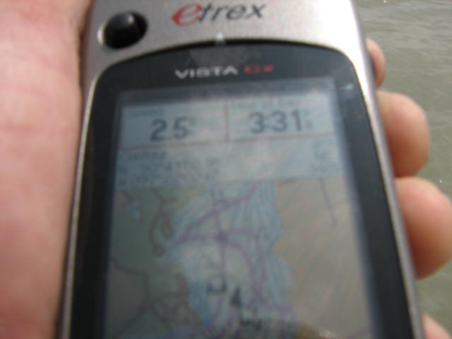

To bow mount it you have to reverse the handle. I also had to use a bolt in the tilt gears to keep it from occasionally popping up. It can pull my boat between 2-2.7 mph (gps). :biggrin2
