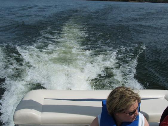

Thanks for the vid - the water seems pretty turbulent there too rather than a defined wake that I'm used to but I'll show you the video if I get out on the lake tomorrow.

#4 Post by dbltrblpapa » Sat May 01, 2010 7:15 pm
Hey Steveclv,
Congratulations on the new toon. Here's a pic off the back of my boat from a few weeks ago if it helps.
