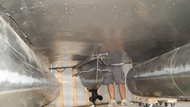

Install in the water?? are you talking about the underskinning? If you got a scissor trailer just crank it down onto some wood blocks and pull the trailer out from under the boat.busatom wrote:I have a scissor trailer but think it may be easier to install in the water??? Wanted to wait till winter but cold here in Michigan ! And I wanna polish & sharkhyde da toons in da winter months!
Tom
Check out my boat it leave it on casters all the time.
- DSC07670.JPG (61.39 KiB) Viewed 3388 times
