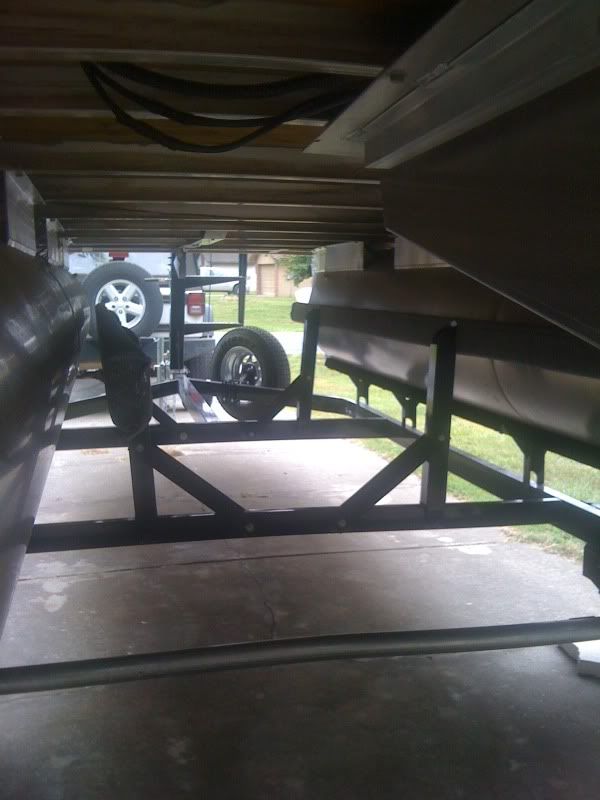

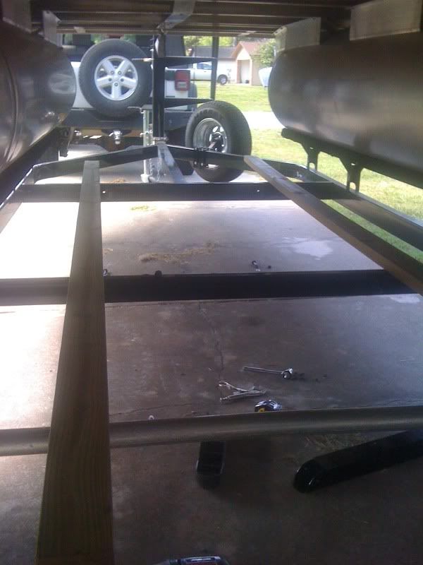

What I did was take the interior guide posts off, turn them around, and bolt 2x4x12's to them. Then I cut some 18"x1/8" thick steel straps with holes on a 16" center and use that as supports to keep the guide posts from bending inward. So far it works like a champ.
Here's a pic with the guide posts removed. You can see one of the guide posts lying on the ground. Just turn it around so that the flat side is up against the 2x4.
And now a couple with the guides reinstalled turned around with the 2x4's and steel straps.
