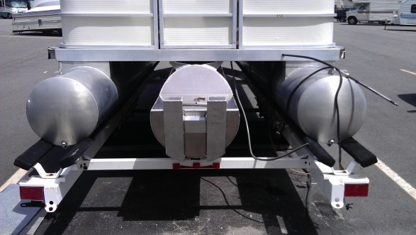

#6 Post by mofn » Sat Jun 02, 2012 4:58 pm
The new center tube, 24" with motor mount as shown. 19" toons on the outside.

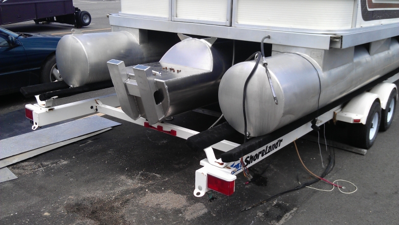

#7 Post by mofn » Sat Jun 02, 2012 4:59 pm
Second pic of the center toon

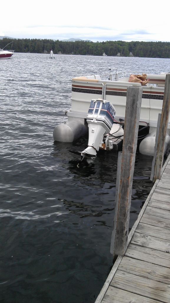

Now for the update, have pics will put them up soon. Just got back from the big lake, and was blown away by how high it's riding! The pics, due to the angles do not due it justice. I gained more than four maybe six inches????? No saggy butt in the rear anymore. What shocked me was I gained in the front also. The front curve of the toon looks to be only drafting a inch to 1 1/2 inches?? It looks to be level across the length of the boat, something I did not think would happen. As for how it ran, only moved from one dock to another, and I then flooded the hell out of it, and gave up trying to start it, rain... was loading stuff on it... just gave up on it. Will be back on Saturday too take it out then.
As for the person who was going to add strakes, hold off. Mine may be diffrent from yours, I do run light, as far as having a ton of toon furniture etc etc. With the front now drafting so little, I think i'll get up on plane much faster?????? Will know Saturday, the magic number to beat is 21.9 mph, before to day I was just hoping to keep that, I now think I can beat it! I wish I did this years ago, after seeing the results so far!

#12 Post by mofn » Thu Jun 07, 2012 9:21 am
Pic before it started to rain. After reading the last post checked the graph at the place I bought it from. I screwed up, it's 1276 lbs of "weight capacity" my bad.

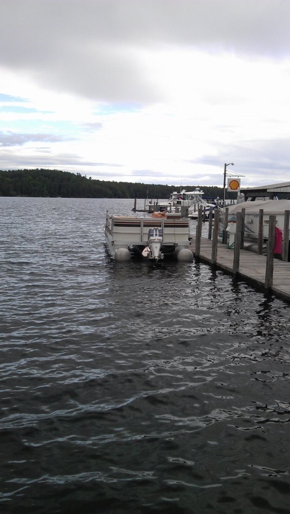

#13 Post by mofn » Thu Jun 07, 2012 9:23 am
A little closer

#15 Post by spurhunter » Fri Jun 08, 2012 8:19 pm
Holy shit that thing rides high!!!! I bet your speed will be pretty good, yes there is extra log in the water, but your going to be riding so high its going to act like a damn flat bottom! LOL
