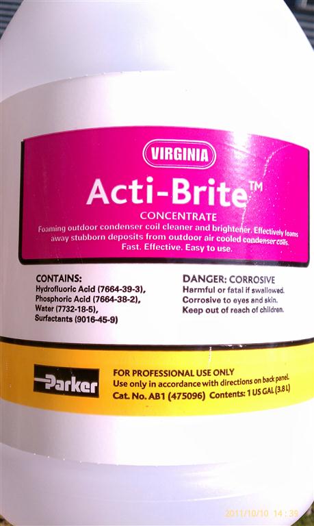

I would imagine it has been mentioned here many times before. Pink coil cleaner is the easiest, cheapest and quickest way to clean them toons. I put it in a pump sprayer. Spray 1 half of a tube at a time. Let it sit for 2-3 minutes then just hose it off. No scrubbing nothing. works like a charm.
- IMAG0282 (Medium).jpg (94.24 KiB) Viewed 9969 times

I reviewed the MSDS sheets for both products and both contain hydrofluoric acid & phosphoric acid as the main ingredients. Both companies are vague as to the actual concentrations so I have no idea if one might work faster but I'll bet the results are the same. Buy which ever one you can find.
IMO you will get some streaking of the paint on a trailer if this stuff hits it undiluted. These solutions come in poly jugs so it *might* not harm synthetic carpet but I would generously rinse carpets & bunks just to be safe.
