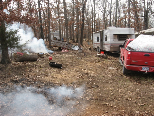

Here is lot during clean up again forgot to take after pics, going back down in three weeks to maybe start on deck.
