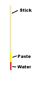

Water doesn't mix with gas. It will "puddle" at the bottom of the tank. While water may be suspended in gas if the tank is agitated and gas sloshed around, after sitting still for a while, the water will settle at the bottom with the gas floating on top of the water.
Coating the bottom couple inches of a stick with water sensing paste will tell you how much of a layer of water is at the bottom of the tank. (See my diagram)
You show that your engine is a 2010. The fuel filters installed on your engine, if you're using Mercury filters, do collect and filter out small amounts of water. If there's an excessive amount of water, the filter will fail (fill up) just as it would with excessive amounts of other contaminants.
There will always be some some minute amount of water in the fuel, due to condensation in your tank or the tank at the gas station/marina. Although most stations have water filters in line between the tank and the pump. With today's gas mixed with up to 10% ethanol, that water will bind with the alcohol and remain in suspension. This is the water that the filters, even your engine fuel filter, are designed to collect. The water paste will not detect water in suspension with the fuel. Only that which has collected at the bottom of the tank. If there's an excessive amount of water, the water will collect the ethanol and also settle at the bottom.
If you ever look at fuel treatments designed to eliminate water in fuel, you'll see that they're pretty much just alcohol.
- Water.jpg (6.64 KiB) Viewed 4399 times

Thanks BC, very clear explanation and great diagram.

If you pull the filter and pour what's in it into a glass or mason jar and let it sit for a minute, any water will settle at the bottom and you'll be able to see the layer of water at the bottom.
