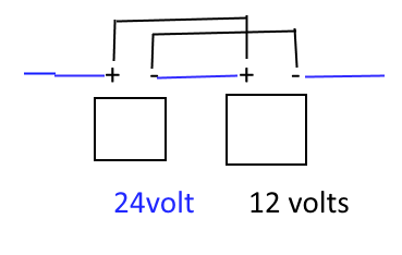

#30 Post by photonfanatic » Tue Oct 20, 2015 6:23 pm
Also my friend came over and better explained what he was talking about. We made a little pic to show what he wants to do. Basically we would just be running series, AND parallel at the same time. Is this possible? Trolling motor would of course be running off the 24v, and all these lights that I want would be running off of the 12v. And I would of course want them to be able to run simultaneously, because I'll be doing some night fishing.
