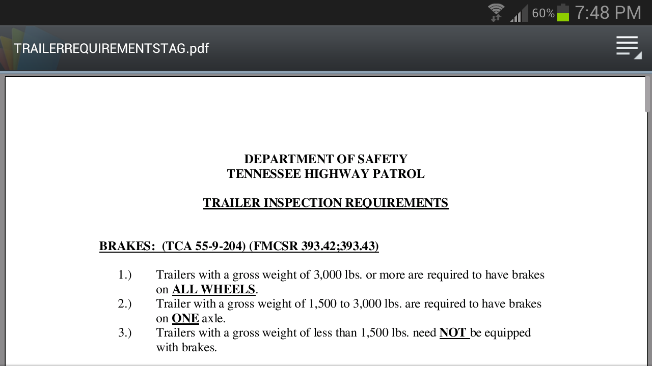

BobG mentioned Tennessee required brakes on trailers above 3000#... I looked it up and he is correct... see screenshot below...
So I called Tracker today and spoke with the warranty guy... He admitted that it was purchased as a boat and trailer package and that it was the retailers responsibility to make sure the packages they order and sell meet local requirements and that I would have to speak to the dealership that sold it...
I called them this afternoon and the "Boss" wasn't in the office today... I spoke with the service manager and he told me to bring it to them with a copy of the state law and he would see what they could do... Everyone that I have spoke to and dealt with from Tracker at this point have been very friendly and helpful... we'll see what happens...

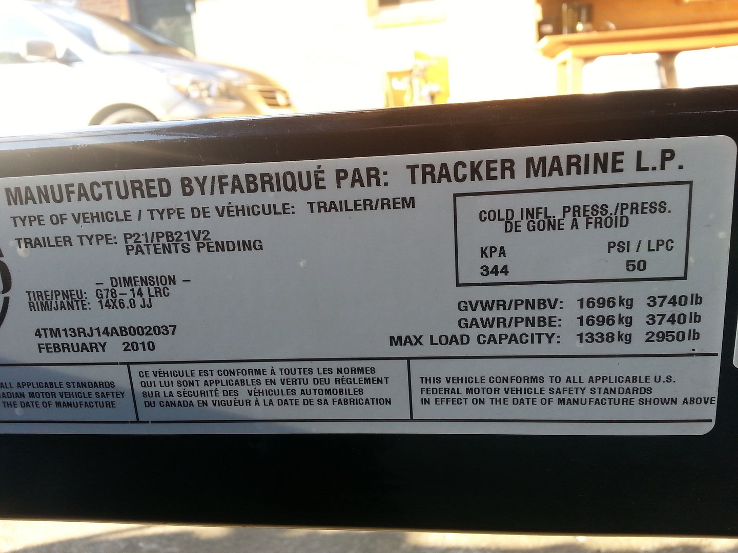

I am going to repost what I posted before:
Dry weight for the fishin barge is 1830(from NADA)#. Weight of the 90HP motor is 400#. Let's say 500# for the trailer(might be on the low side). 30 gallons of fuel is 180#.
That total is 2910# and that is without anything else like life jackets, line, anchor, batteries.
Look at the sticker on the trailer. Is 2950 the payload or the total weight including trailer?
On my tandem tracker trailstar, the gvwr is 4500 and the capacity is 3500. This is a dual axle trailer. The axles are rated for 2250 each according to the sticker. Yours should have the identical sticker.
Believe it or not, in some places they can put brakes on or not based on the empty trailer. Some unscrupulous boat dealers take advantage of that.
Mercury 90 4 stroke
Mercury 90 4 stroke
Re: Trailer tires wearing badly
No doubt... I could see them doing that if they sold the trailer by itself... they sold this as a package... I see what you're saying... the boat and trailer combined weight as sold could have possibly been under 3000#... but it's still over 1500#... (see requirement #2)babock wrote:Believe it or not, in some places they can put brakes on or not based on the empty trailer. Some unscrupulous boat dealers take advantage of that.
Here's my boat sticker...
