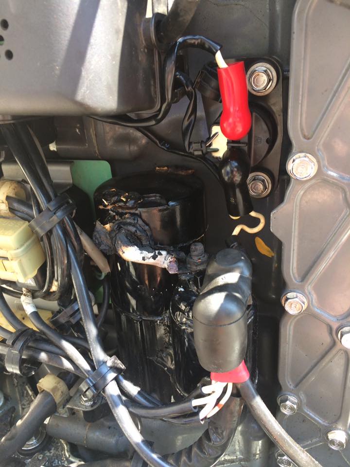

Update: The starter / solenoid gave up the ghost in dramatic fashion Sunday. Wife had the boat out with friends while I stayed at the house working on some other stuff. She tried to start it to come home. Said she heard "noise" coming from the outboard, but it wouldn't start. It became weird when she said she turned the key off but the noise in the motor continued. Soon she and passengers smelled something burning. Then a big cloud of smoke came out of the motor and the noise stopped. Friends towed her home.
The big wire between the solenoid and starter clearly fried. I haven't ever seen this on a starter before. Anyway, ordered an aftermarket starter / solenoid from Amazon and installed it Wed night. $109 delivered with a one year warranty. Doesn't appear to be any other damage to the motor. No fuses blown and it started right up when I reconnected the battery.

nothing like smoke coming from the area, to help diagnose the problem!
i guess it wasn't the fluid level in your key switch, after all!
glad all is well, and glad the price was good... sometimes smoke from a motor can be a tad more expensive

[quote="sunedog"]Update: The starter / solenoid gave up the ghost in dramatic fashion Sunday. Wife had the boat out with friends while I stayed at the house working on some other stuff. She tried to start it to come home. Said she heard "noise" coming from the outboard, but it wouldn't start. It became weird when she said she turned the key off but the noise in the motor continued. Soon she and passengers smelled something burning. Then a big cloud of smoke came out of the motor and the noise stopped. Friends towed her home.
The big wire between the solenoid and starter clearly fried. I haven't ever seen this on a starter before. Anyway, ordered an aftermarket starter / solenoid from Amazon and installed it Wed night. $109 delivered with a one year warranty. Doesn't appear to be any other damage to the motor. No fuses blown and it started right up when I reconnected the battery.[/quote]
Your starter shorted to ground internally, that's about the amp draw it takes to melt a wire of that gauge. At least it exposed itself and its fixed now!!
