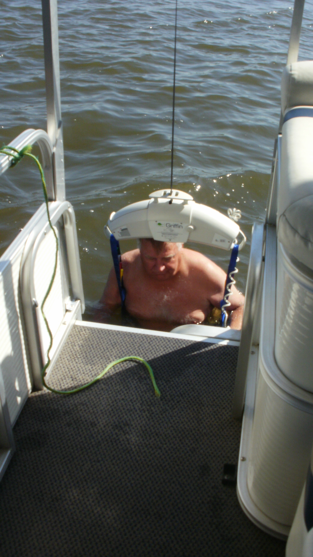

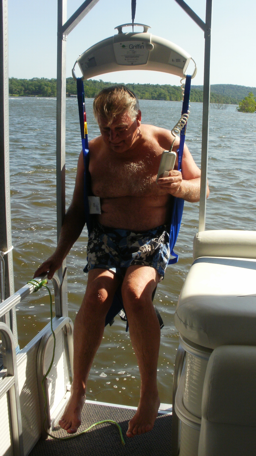

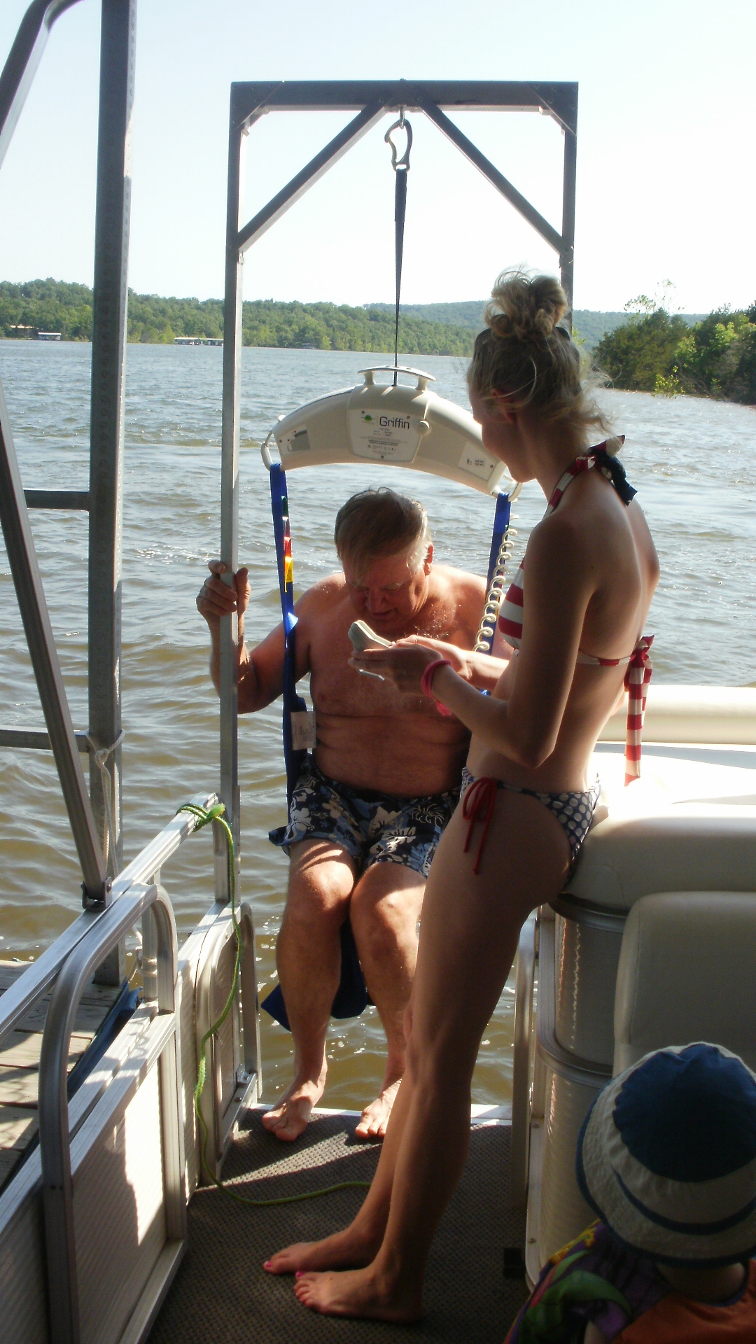

Lift to Pull Disabled From The Water
Pics of lift trial, everything worked great!
- Lifting back out of the water
- Lift hoist2.JPG (889.99 KiB) Viewed 3503 times
- In the water
- lift hoist3.JPG (841.84 KiB) Viewed 3506 times
- Going down using the lift
- Lift Hoist1.JPG (897.16 KiB) Viewed 3502 times
2014 Regency 254
Mercury 250L Verado
Mercury 250L Verado
