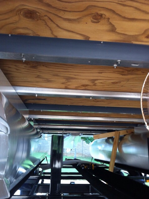

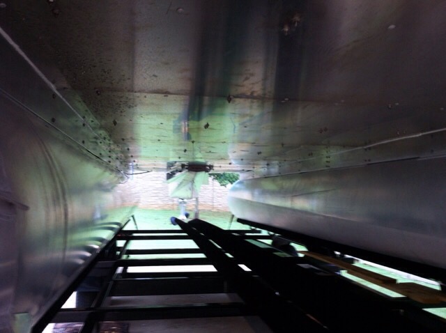

Finished at last! The underskinning looks great but I am unable to upload the pics. I get an error message each time I try. I'll post pics as soon as the system will let me.
Had a plan change. The borrowed 10.5' sheet metal brake would not bend the long pieces of .063 aluminum for the side panels. It was Friday and too late to try and find a fabricator who could bend it, so I cut each 8"x96" piece into 2 4"x96" pieces for the side panels. These were attached with #10x24 type F self-tapping SS screws with SS bonded washers to make them removable. The corner seam between these 2 pieces was sealed with 3M 5200 to eliminate possible metal-on-metal rattles and squeaks. The contact surfaces were sanded and then cleaned with acetone so the 5200 would adhere better. The underskinning was attached using existing C-channel bolts and 3/16" truss head aluminum structural rivets as suggested on this forum. The Harbor Freight pneumatic riveter that I picked up for about $35 worked great.
Will find out his weekend what benefit I got from underskinning. Maybe the fish will like it because they are the only ones who will see it. I just hope the goons at the marina who are beating up my logs with the fork lifts don't destroy my nice new underskinning.

I tried posting pics from my iPhone which has not been upgraded to IOS 8 instead of the iPad using 8.0, which would not upload. Hopefully it works, the pics are sized correctly and are in correct order.
- image.jpg (70.24 KiB) Viewed 2805 times
- image.jpg (91.56 KiB) Viewed 2805 times
