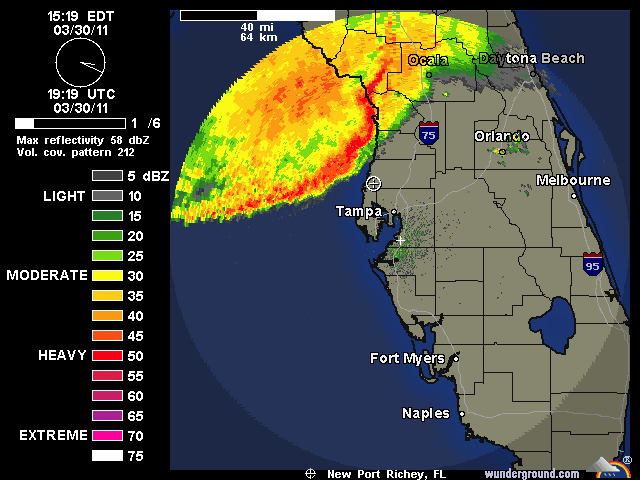

I guess that is always a possibility. When I bought it the pontoons looked very smooth and pit free. I purchased it from an individual who appeared honest and knowledgable. He let me take it for a sea trial and all seemed well. That being said I am still going to take it to the marina as soon as the weather allows (we have tornado warnings until 8:00pm tonight) get it on a lift, power wash, scrape off barnacles, get a very close look at it alongside an expert, and proceed from there. If need be I will strip off all the paint and redo it correctly.
- This is the only thing keeping me from the marina!
- storm radar.gif (246.49 KiB) Viewed 2670 times

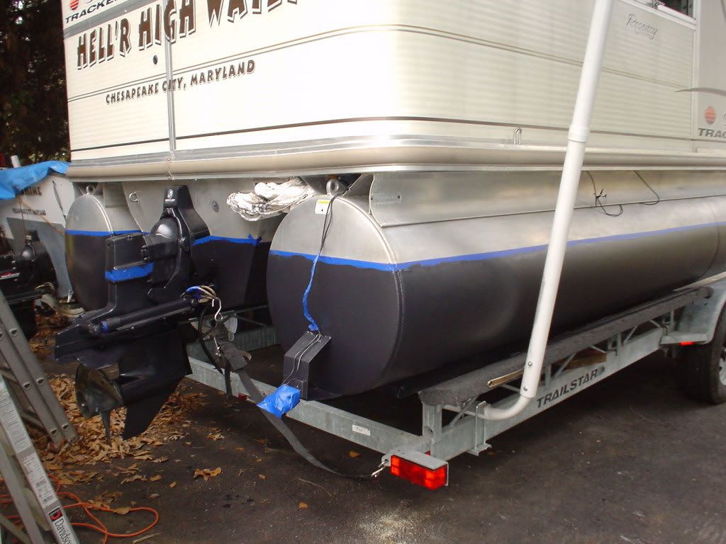

I have 3 coats of primer on mine. I am repainting either tomorrow or Thurs (waiting in UPS to deliver my paint)..I'll probably do 3-4 coats of Trilux 33. After 4 years, the primer is still as thick as the first year it was applied (that's why I asked if you could see the primer)...the paint will slough off leaving the primer behind, it's pretty obvious if it had primer on it or not.
BMR, if you get a chance to take some pics of you painting you toons that would be very educational for me. From what I hear it needs to be done about every 18 months...probably once a year in my case. How do you paint the part of the toon that is resting on the trailer boards? Do you jack it up?
I know giving bad news sucks, but I appreciate it.
Don't beat up Gregf too bad. He was right about one thing. My grass turned green last month and there wasn't copper anywhere near it.
sorry Greg, I can't pass up an oportunity for Comedy...nothing personal
Re: Fouling and Lightening

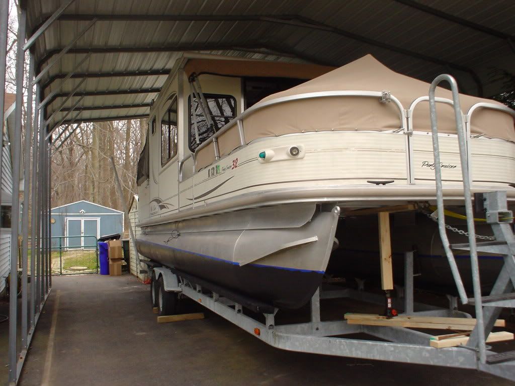

What I do to paint is put several 2x4s under the deck (bow and stern) and use a hydraulic jack in the stern and a screw jack up front. You only have to jack it up far enough to clean and enough to get the paint roller under there. The PC is heavy as hell (5500 lbs dry) and its pretty easy. Should be easier for you.
I jack one side, clean and paint (3 coats) the log and engine pod, etc. Then let it dry over night, lower it and do the other log.
Up here, I repaint every 3-4 years and touch up every year. Saltwater and your year 'round season, at least every 1 1/2 years.
