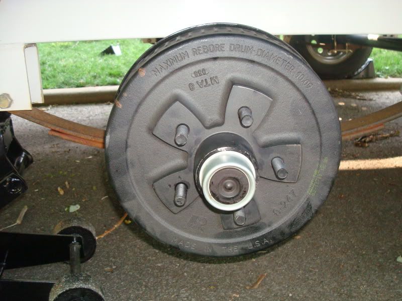

Once I had decided on the drum brake assemblies, then I needed the drums. This is probably the single most expensive part of the mechanical side of the brakes. When I purchased the drums, I had to make sure that the bolt pattern was the same as my hubs, so I wouldn't need to buy new wheels/tires. My trailer wheels are 5 on 4.5" bolt pattern, so I found 10" brake drums, with a 5x4.5" bolt pattern, that came complete with new bearings and caps for about $82 each. With the brake backing plates, and the drums, I was ready to go as far as the mechanical side of the brakes was concerned.

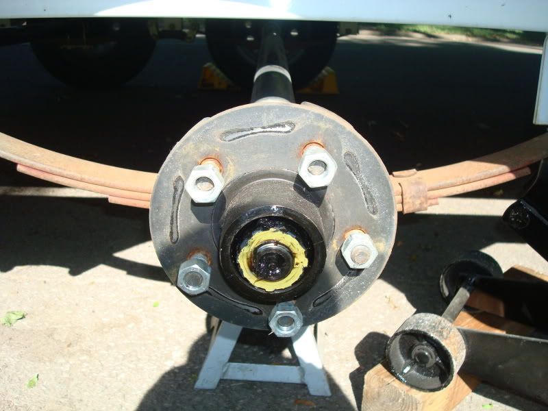

I removed the wheels on the trailer, and then removed the grease cap on my hub. Be careful here not to damage your cap, as you may want to re-use yours. I choose to re-use mine, as I felt they were superior to the ones that came with my new drum/hub assemblies.

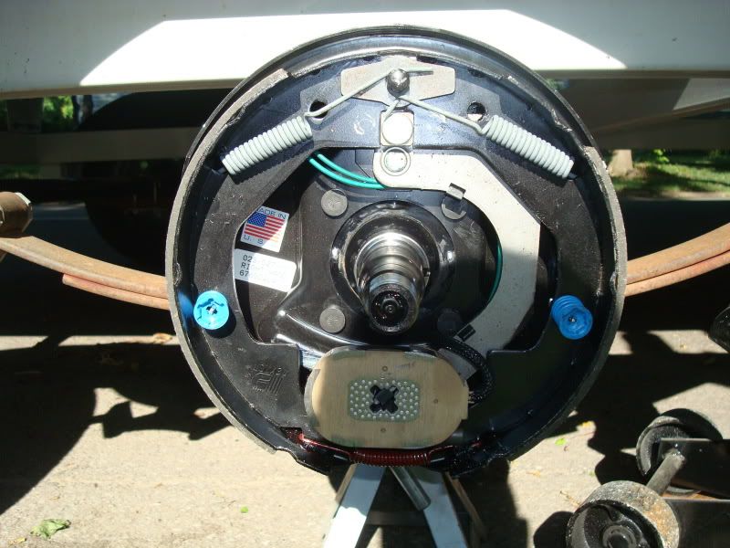

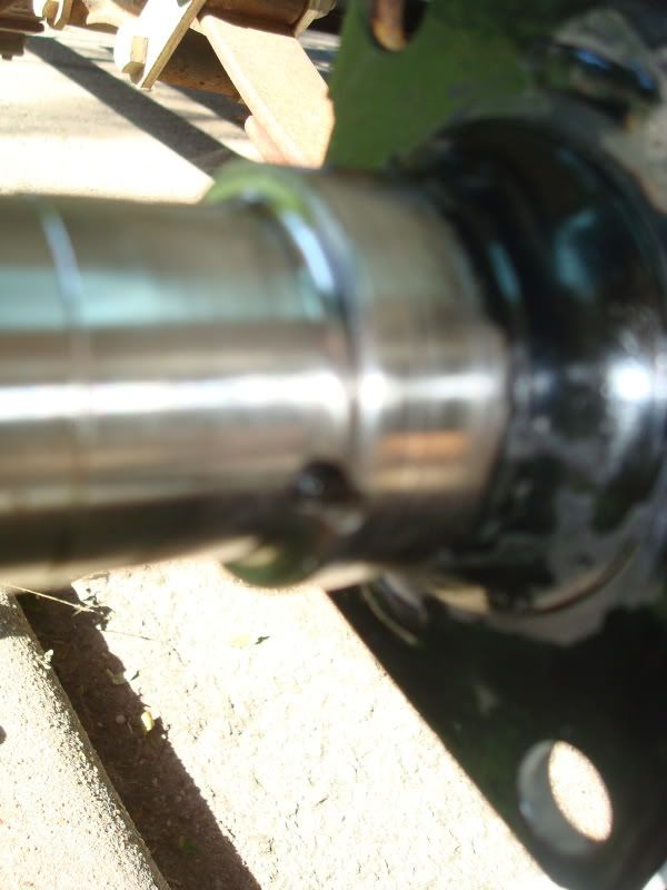

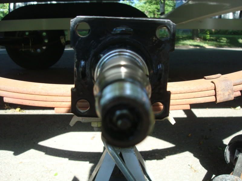

Once the old hub was off, it was time to clean and inspect the spindles. My spindles, as I suspected, looked excellent, so after a good cleaning, I was able to bolt on the brake assemblies. You can see in the last picture of the spindle that there is a little hole where the grease comes out when you grease your spindles. I made sure there were no obstructions in this, and continued on to the brake backing plate installation. A note here that the brake assemblies did NOT come with the hardware to bolt them to the brake plate on the axles. I had to stop in the middle of the job to go get bolts, lock nuts (with the vinyl insert) and lock washers to bolt the brake assembly to the plate on the axle.
Notice here that there is a Left, and a Right side brake assembly. You always want the magnet (yellowish box) down, and the metal arm (silver part) to the front of the trailer. This will ensure correct adjustment of the shoes, and that they work the way they should.

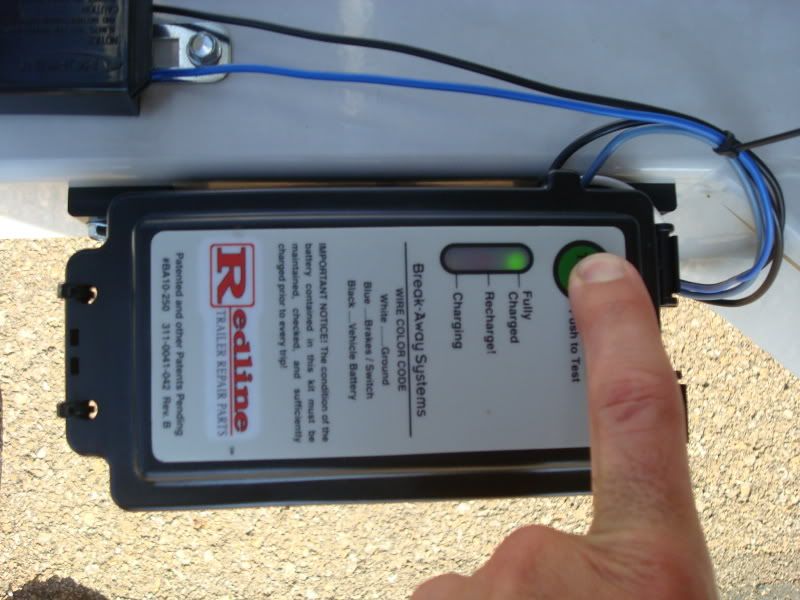

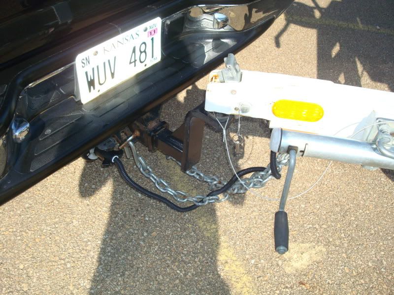

Now I was ready to tackle the electrical side of the brakes. It is now a Kansas Law (and probably every other state as well) that if you have electric trailer brakes, you MUST have a break-away safety kit that will activate the electric brakes on the trailer if it were to ever be separated from the truck while being towed. This extra piece of equipment was the most expensive single piece, but it is required by law to have, if you have brakes. I purchased my break-away kit for $95 which came with the battery, battery box, break away switch, and on-board charger and indicator light. The entire thing comes in a box about the size of an ATV battery, that you mount somewhere on the tongue of the trailer. Once I had this mounted where I wanted, it was time to run some wires.

From there I had to run my constant power to the break-away kit (battery box) from the vehicle. Obviously one side of this wire will go from the 7-way RV plug, and the other will go to your power for the break-away kit. This will ensure that whenever the 7-way plug is plugged into the towing vehicle, then you will be charging the battery for the break-away kit, in-case the trailer falls off. Next I wired in the actual switch that tells the kit to engage the brakes if the trailer becomes disconnected from the truck. I won’t go into how to wire this, as all of them come with easy to follow instructions. I will say though that you need to pick a good place to mount the switch assembly to your trailer tongue so that there is a straight, clear, un-obstructed path between the switch and the connection point on the vehicle. My switch came with a wire that connects the switch pin to a loop in the wire that I simply loop around the 2†ball before I connect the trailer to the truck. This way if the trailer comes off the truck, it will pull the switch, and engage the brakes. I made sure to make the switch cable slightly shorter than my safety chains so that if the trailer comes disconnected, it will pull the switch and hit the brakes on the trailer before I bottom out my safety chains. I hope that by doing it this way, if this ever happens, it will prevent the trailer from doing major damage to my truck because it will be braking before I do, and will keep the trailer away from my truck, and not bouncing off of it to stop.
