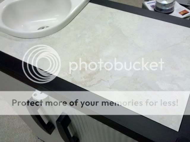

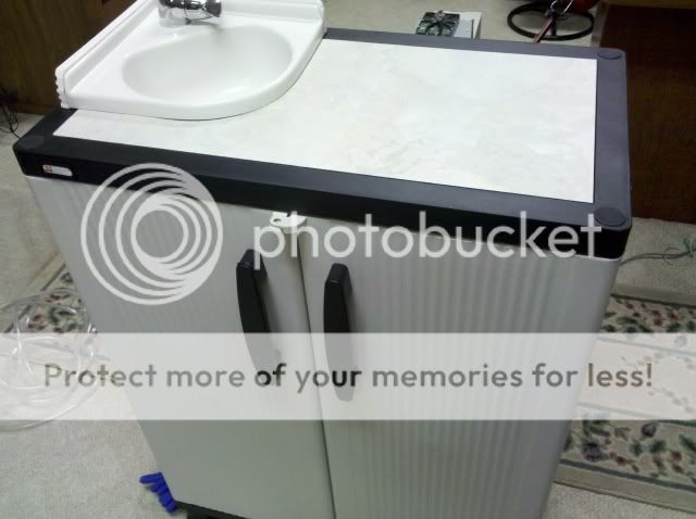

#13 Post by SGTiger » Wed Aug 10, 2011 3:25 pm
Thanks everyone. Here is an update:
As I mentioned earlier I did not like that black top. I decided to add a stone look to the top which helps tie the color of the cabinet to the color of my existing furniture. Its kind of hard to discern the various colors of the top from the photos below. The top actually has a stone like texture, which I like, instead of a smooth finish.

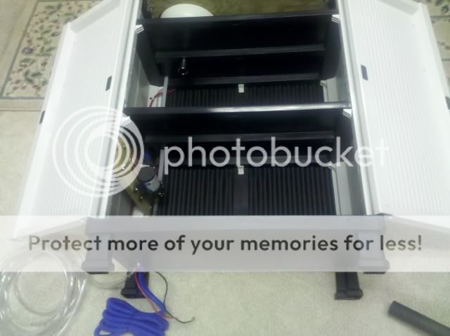

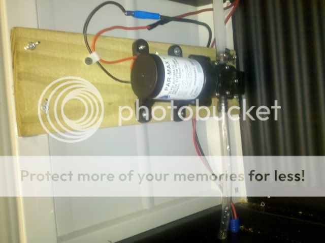

I mounted the water pump along with a toggle switch which is at the very back just below the faucet handle. I wanted it to be close in case I turn on the faucet only to realize I didn't turn the pump on at the beginning of the day.
Next up I want to add folding shelves to each side similar to the shelves that some grills have. I hope to add the stone look with black trim to the shelves. The shelves (15"x 13.5") will fold down when not in use, but should add much needed "counter" space when cooking/grilling. The folding shelf brackets are on the way from Amazon.
