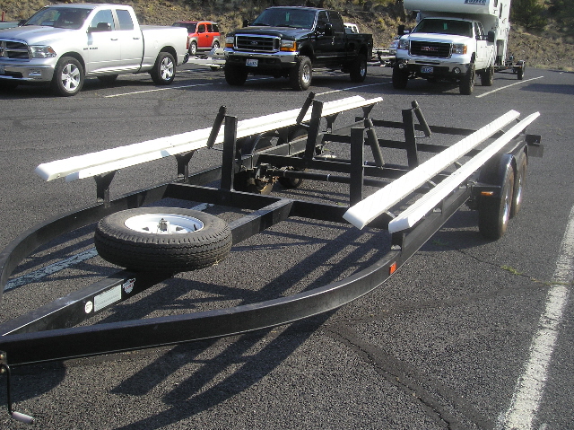

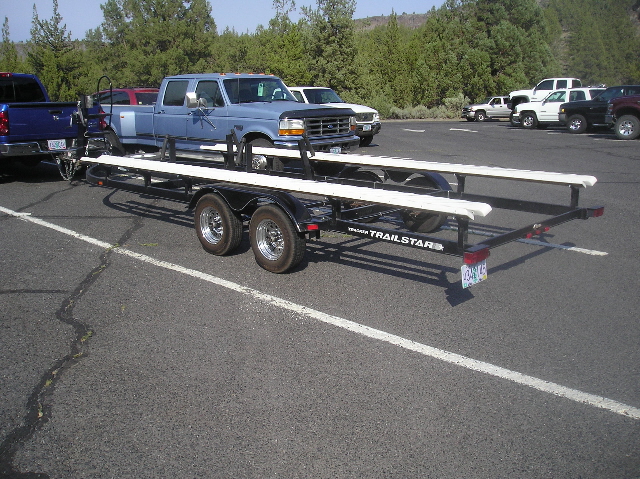

Here's pic's of the real deal. No carpet, no counter sinking, no exposed wood, worrying about the extra height etc. They also have the clean finished look of rounded ends fore and aft and the directional groves allow for water to run off so you do get the hydroplane slick "ski jump" launch. And yea, I kinda feel for a second that my sh$t don't stink when I park next to all the other trailers with ripped up carpet and rotten wood at the marina.

Chillin, my carpeted bunks are still in very good shape, but I like that set up you have... obviously 2 for each bunk... are those one continuous piece of material or several lengths butted up against each other? It does look good.chill'nthemost wrote:Here's pic's of the real deal. No carpet, no counter sinking, no exposed wood, worrying about the extra height etc. They also have the clean finished look of rounded ends fore and aft and the directional groves allow for water to run off so you do get the hydroplane slick "ski jump" launch. And yea, I kinda feel for a second that my sh$t don't stink when I park next to all the other trailers with ripped up carpet and rotten wood at the marina.http://www.easternmarine.com/Self-Cente ... er-86162-/

Roland, your math is correct, I spent about $300 on the caps. I know it seems like a lot, but I don't foresee ever replacing them again. You do have to butt the sections together, but they fasten on the sides with stainless wood screws and at least on mine I was able to make the sections match up perfectly. I pre- assembled everything on saw horses first. The only thing I drilled in place was the bunks to the trailer mounts after I clamped them in place. I used carriage bolts instead of lags. As far as the open wood on the bottom, I used Douglas Fur and applied a high quality wood preservative to the top, bottom and sides. I'm sure you could use Pressure treated since the toon would never touch the wood, but PT is made out of soft sap wood so it can easily be injected with chemicals. The bottom of the wood dries out fast since it's not covered in carpet and with the wood sealer I put on it I don't think it will be an issue for years. Even for the tops and sides the caps have raised groves so air can circulate to dry the wood between the plastic and the wood.
As far as launch and loading.....huge difference, especially loading
