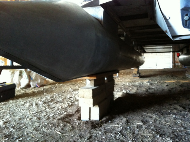

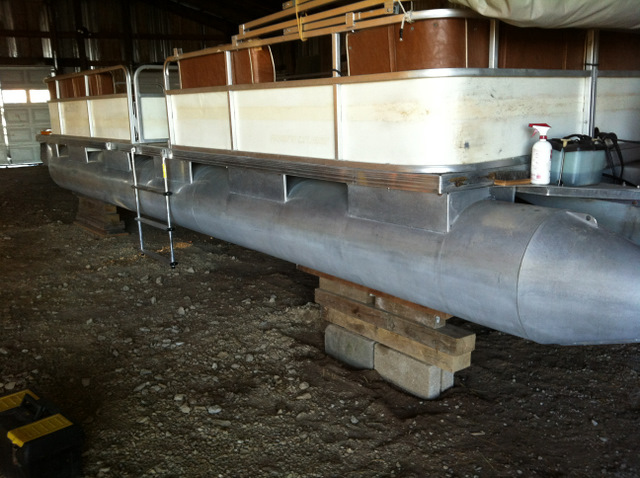

#6 Post by MichaelB » Thu Dec 29, 2011 5:02 pm
I have a center support trailer. For me, it is putting a bottle jack under the trailer, raising the boat and trailer off of the ground. I then block it up. There's a angle running the length of my pontoons on the bottom, so I have some 2x8's with a cut out down the center so that the angle sits square in the middle and is supported on both sides.
It's plenty stable - I climb on and off and work all around it. Reverse the process to put it back on the boat. Easy peasey.

That is one big fucking toon!! I like it.
