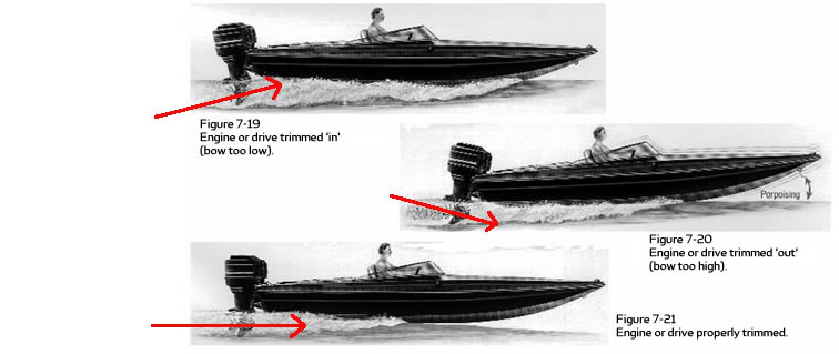

the trim helps get the front of the pontoons up out of the water so there is less drag and you can go faster with less power. It is not as noticeable with a pontoon boat as a boat with a conventional hull but it does make a little differance, youll need to try a few different trim settings to see what works for your boat. maybe this will help it's not a toon but it is the same idea.
- trimanglerev.jpg (36.24 KiB) Viewed 5925 times

Aaah, this is a good visual for me, thanks. Now I can see if the motor is trimmed in too much how it forces the bow into the water. And, if trimmed out too much, the thrust will raise the bow up too much. The final example shows the right trim.WILD MAN wrote:the trim helps get the front of the pontoons up out of the water so there is less drag and you can go faster with less power. It is not as noticeable with a pontoon boat as a boat with a conventional hull but it does make a little differance, youll need to try a few different trim settings to see what works for your boat. maybe this will help it's not a toon but it is the same idea.
Thanks for posting the illustration WILD MAN.

That graphic is great for showing the correct trim. Watch a bass boat or small runabout try to take off with the trim up and you'll see a classic case of porpoising. It happens also (I have a bass boat) if you slow down and don't trim the motor back down.
