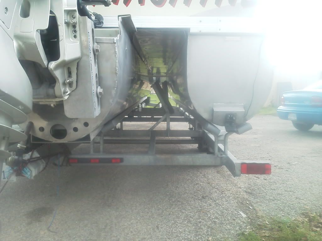

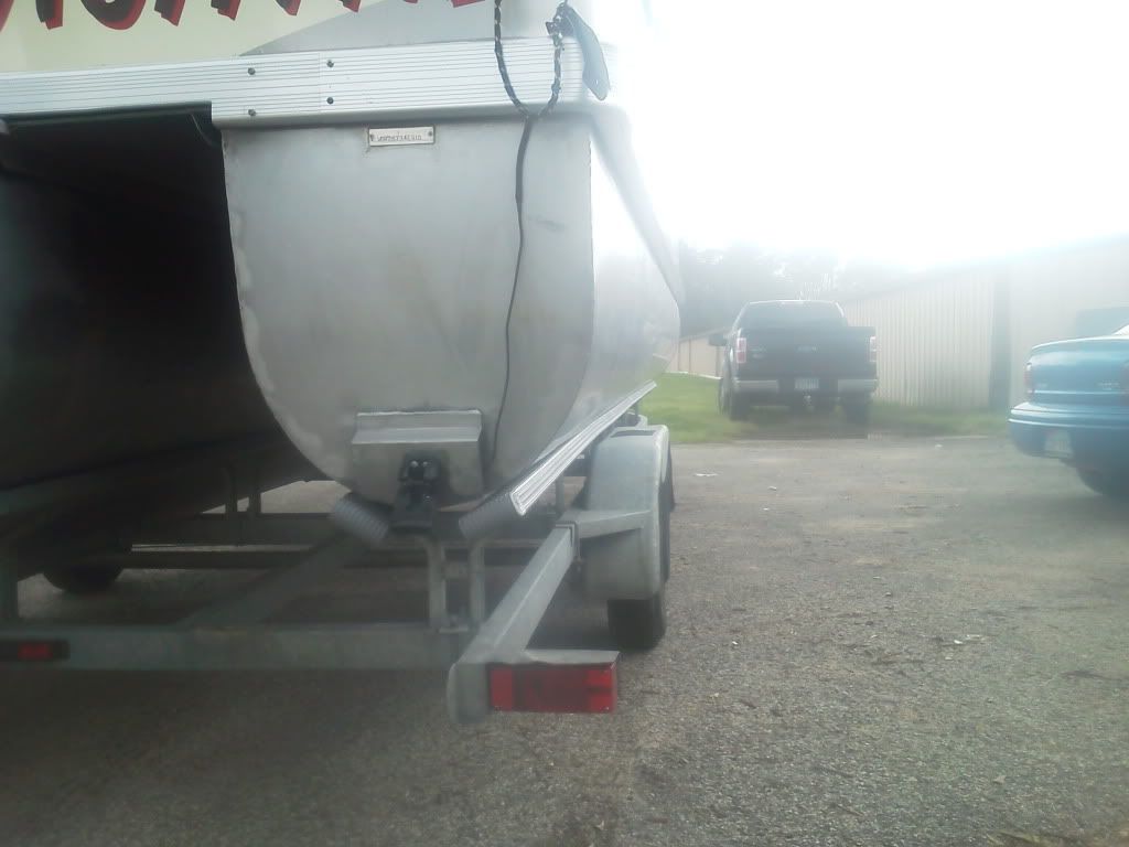

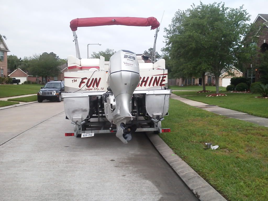

Here are some before and after pictures. (Notice the jack plate)

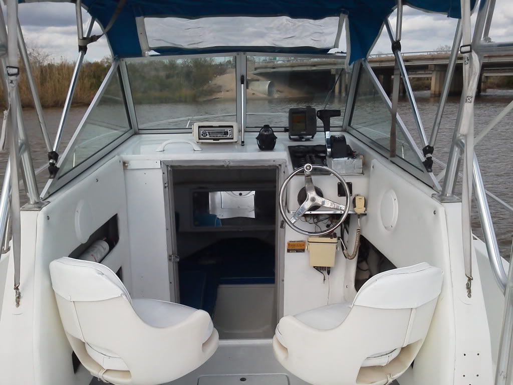

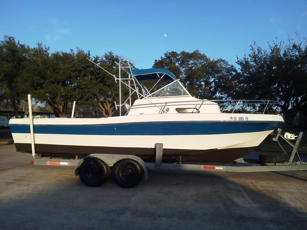

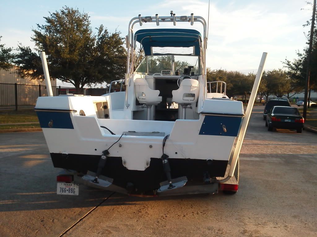

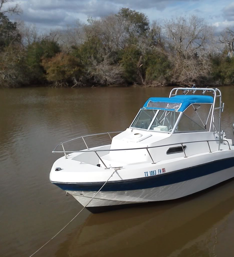

Here are some pictures of the 24' invader after the restoration:

Yes, the strakes are 4" x 4", which gives you an extra 24" of flat surface to plane on. Before I started this projects I took several pictures and measurments on stock pontoon boats from several manufacturers at the Houston Boat show. 4" seemed to be the industry standard.
As for why not the whole length, when your boat is on plane you are really only riding on the back 1/2 to 1/3 of your logs, so after about 15 mph I start to jump up on those strakes, so I did it mostly because of cost. (Not really worth the extra money to have the strake the full length of the log when it only rides on the back half anyway). This way I purchased 4 sticks for a total of about $500 bucks rather than 6 sticks for $700.
