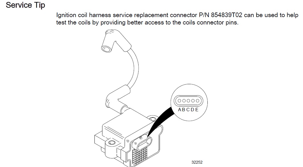

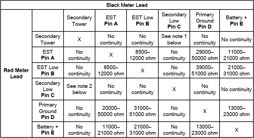

I found a pdf online talking about PCM failures and it had buried in it the procedure for testing the coils using a ohm meter
http://www.marinemechanic.com/merc/dist ... ilures.PDF
I don't have the test harness that they refer to, but based on my preliminary attempts to read the resistance, I suck and getting the tips of needles to touch. My tester has sharp round points on it and the terminal ends on the coil are sharp round points tucked up almost 1/2" inside the housing (so you can't easily touch their sides or the wide flat parts)
I will get some readings and a spark tester later..
