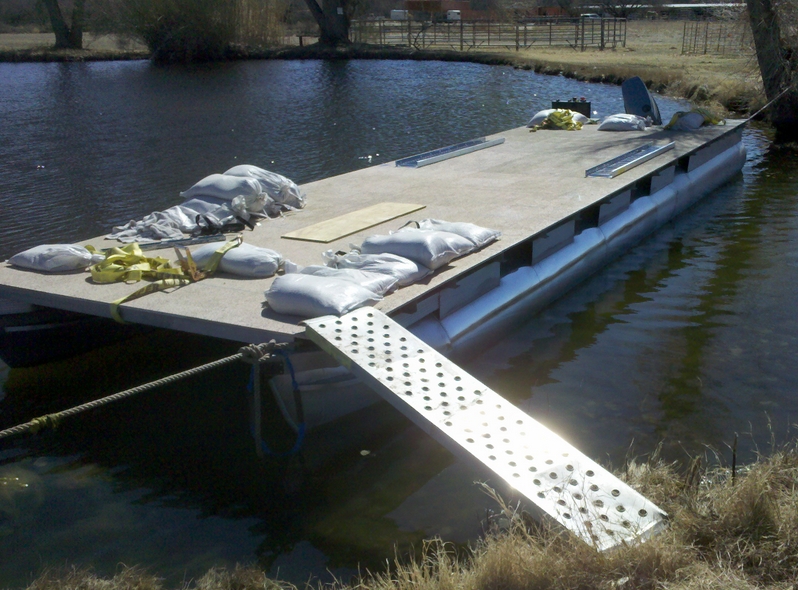

I'll have to agree that submerging is the BEST, SAFEST and only foolproof way to find leaks. That's exactly what I did with mine when I took ownership of my derelict 1988 Party Hut - and before I started a year long build.
It's EASY to submerge one side at a time by simply piling sandbags on that side, it took 20 (a bit over 2,000 lbs. since I had the large size) to completely submerge mine. Sand is cheap, sandbags are cheap. I hired a couple of teenagers to fill 'em and pile 'em on while I drank beer. Look for the bubbles, then jump in with a dive mask and circle the spot(s) with a black wax dish marking pencil.
If you went the pressurization route Leak-Tek detection spray is dirt cheap and FAR superior to soapy water. It's what professionals use. It will provide LOTS of bubbles on even the smallest leak. A lot of the leaks come from cracked welds where the log attaches to the mounting bracket - they're sometimes almost impossible (especially on the inside of the bracket) to see without a telescoping inspection mirror and bright flashlight.

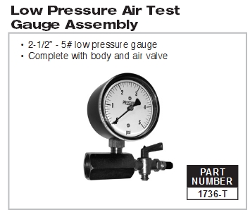

Another quick way to check for problems and one that is very reliable is a simple leak down test with a low pressure test gauge.
Simply pressurize each chamber to 2 or 3 psi and see if the needle moves down. I would give it 15 minutes and keep the log out of the sun while testing on a cool day. You may need to adapt some common plumbing hardware to mount to your bung but it already has a Schraeder valve on one side. If it doesn't hold pressure you now need to do further investigation by either submerging or spraying with leak detector. Make sure the gauge and hardware connection with the valve of your log doesn't leak by spraying it right after you pressurize it, you may need to use a wrap of Teflon tape.
Here's one from http://www.pascospecialty.com/products.php that should work perfectly. The little ball valve is especially nice to have since you can meter the EXACT amount of air flowing into the log instead of doing it in spurts.
low pressure test gauge.jpg (49.31 KiB) Viewed 44974 times
I've got the 15 psi version which is also acceptable since it reads in 1/10 psi.
Either one should be around $20.00.
