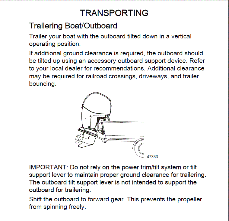

As long as ground clearance isn't a problem it's often recommended to trailer the motor in operational position. That's how it was recommended on my past Honda, current Yamaha, and this straight from Mercury.
Trailering Boat-Outboard.gif (44.08 KiB) Viewed 5411 times
Image Source

We were told by our dealer and a mercury rep to just make sure we have the trim all the way down, no need for transom savers, etc.
Re: Motor support while towing
Posted: Thu Jun 27, 2013 8:39 am
by Woody
rsmith wrote:We were told by our dealer and a mercury rep to just make sure we have the trim all the way down, no need for transom savers, etc.
Yep. If ground clearance is an issue, and motor has to be raised to tow, I would then use some sort of transom saver.
