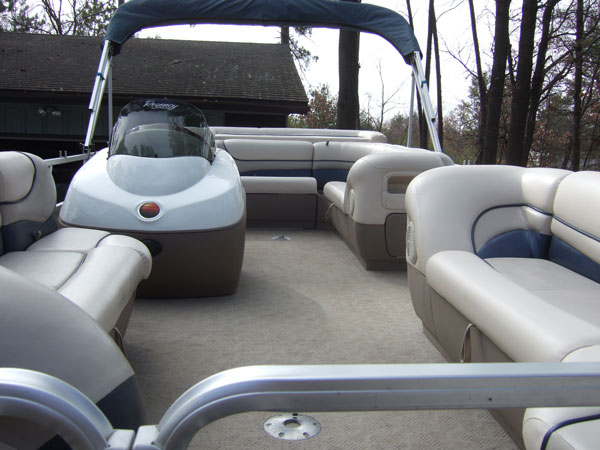

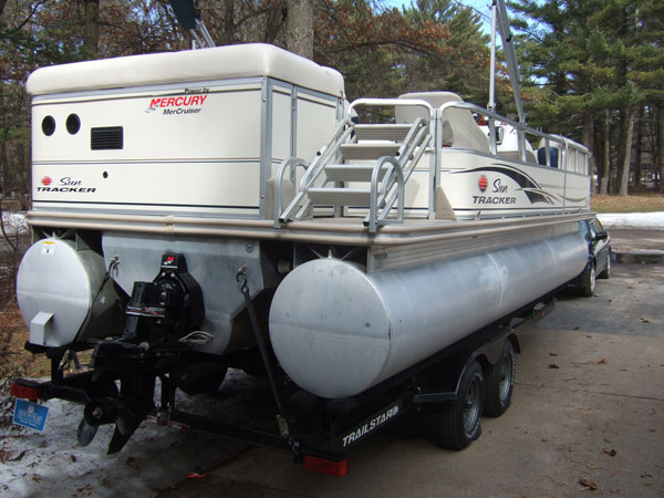

Just took some photos! The 45f weather and snow on the ground is killing me!
- stern-drive.jpg (115.73 KiB) Viewed 6874 times
- inside3.jpg (58.85 KiB) Viewed 6873 times
- back.jpg (69.8 KiB) Viewed 6876 times
- front.jpg (64.92 KiB) Viewed 6879 times
