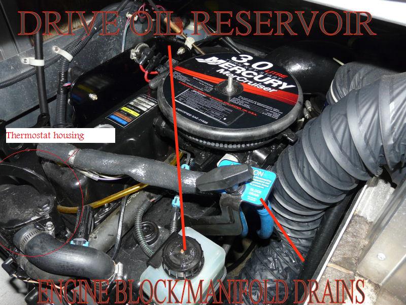

Re: I/O operating temp?
What's it like to change out the thermostat?FloterBoter wrote:right, but the belt driven engine pump is the
regular motor water pump. i should have
said "water pick-up pump". i think with some
later model merc sterndrives the pick-up
pump is up by the engine. or maybe that's
volvo, i don't remember. on my sterndrive
(and most merc's, i think), the pick-up
pump is a plastic housing pump with a rubber
impeller, and the whole thing is located near
the bottom of the lower unit. when that
impeller shreds, pieces of it spread throughout
the cooling system and cause problems later on.
i might go to the blue "run dry" impeller that the
navy uses. it costs a little more, but if the pump
is ever run dry the impeller doesn't immediately
fail due to overheating. it delivers a little less
cooling water flow, but i've got plenty of gpm.
anyway, the way beermunk's temps went up
on the first run of the year and then dropped
sounds like either a late acting thermostat or
a flat spot on the impeller.
_________________________
Buy the ticket - Take the ride.
- H.S.T.
- H.S.T.
2 bolts and undoing 3 hoses, easy. It's right on top and easy to get to. All you need is a flat blade screw driver to remove the hoses and a 1/2 inch socket. With p/s there is 2 gaskets, without, 1.
- P1030529.jpg (111.46 KiB) Viewed 5968 times
