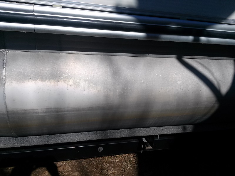

- Here's how nasty the log looked before I started. I had used just the Napa aluminum brightener last year. But did not buff them afterwards.
- cleaning - before_lr.jpg (127.39 KiB) Viewed 2159 times

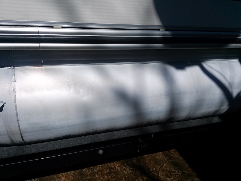

- The white log after spraying on Napa aluminum brightener and hosing it off.
- cleaning - after Napa cleaner_lr.jpg (103.96 KiB) Viewed 2157 times

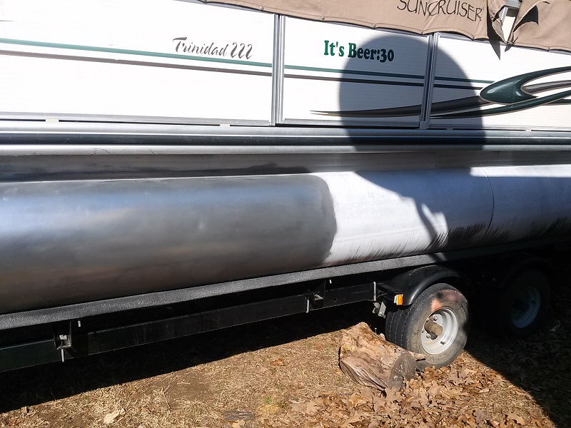

- Half way done with buffing this log. Just doing 2-3' sections at a time.
- cleaning - half buffed_lr.jpg (169.96 KiB) Viewed 2161 times

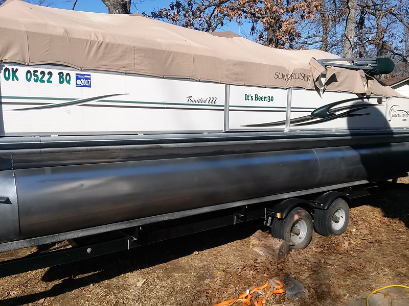

- Finished with this log -- the blue line at the top of the log is not lights from under the deck -- that is the reflection of the blue sky above.
- cleaning - after_lr.jpg (220.74 KiB) Viewed 2158 times
