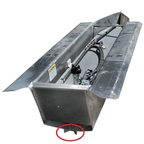

Does your motor pod have a 'V' on the bottom at the very back right before the anti cavitation plate? Mine did and blow-out was a big problem until I cut it off. Now the motor has a good bite and trim is much more effective no matter fuel load or passenger placement. And i didn't have to drop it a hole either.
Re: Prop blowout
It sure does; took the boat out of the water yesterday to build a tow bar and power wash the pontoons and I sure looked at that part and thought what the hell purpose did it serve... I may have to pull out again tomorrow and get ride of that V piece as I can't lower the motor any lower than it is... THANKS!!!Tlowry wrote:Does your motor pod have a 'V' on the bottom at the very back right before the anti cavitation plate? Mine did and blow-out was a big problem until I cut it off. Now the motor has a good bite and trim is much more effective no matter fuel load or passenger placement. And i didn't have to drop it a hole either.

I was in Bass pro to buy come gear and ran into the salesman that sold me the boat. He asked asked how it was on top end and I told him the story of the V-sectomy and how it improved the situation. He said he had heard of this being a problem and some owners trim the V, said it was a splash deflector and went on to say the LU of the 14 Mercs was redesigned (I haven't verified that one) which changed the flow. After removing it, I see no splash-back issues at all and can run 1/4 up trim with no blowout which changes the speed from 25 to 30mph with me, the Mrs, a 1/2 tank of fuel and gear.teecro wrote: It sure does; took the boat out of the water yesterday to build a tow bar and power wash the pontoons and I sure looked at that part and thought what the hell purpose did it serve... I may have to pull out again tomorrow and get ride of that V piece as I can't lower the motor any lower than it is... THANKS!!!
Re: Prop blowout
Well the V thingie is gone.... Report later....
Re: Prop blowout
Ok so the wife and I got the boat out this afternoon for a beer cruise and while cutting off the V bracket sure seems to have made the trim much more effective and allowed at least another 200 RPM... The bow sure seems to hold out the water a bit higher. I can't report any speed difference as I forgot my phone at home but the boat does feel faster. Now on the downside there is a lot more water splashing/boiling up around the motor....
