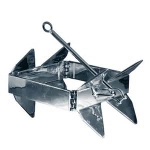

I agree with the other posts. Get you a "box anchor" and it will fold up and can be put in a bucket when back onboard. Needs less rode and can be retrieved easily.

I love my box anchor - and when it's not in use, I keep it in a soft-sided cooler under the seat. Keeps it from banging into other stuff.

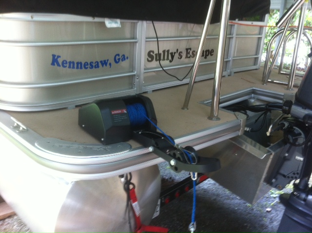

I mostly just drift around, but in a cove I use my Trac 35 Power anchor mounted on the rear deck. It's out of the way and holds the pontoon just fine. It has a remote control. No problems with it at all.

i use the same power anchor, but mounted on front of boat... it might sound weird, but here's why, (beyond the water hitting the pontoon hydrodynamically)..Capt Sully wrote:I mostly just drift around, but in a cove I use my Trac 35 Power anchor mounted on the rear deck. It's out of the way and holds the pontoon just fine. It has a remote control. No problems with it at all.![]()
when anchored from the front, the boat will naturally swing around and face the wind.....
my grill is on the rear of the boat....
when grilling, the smoke doesn't choke everyone on the boat...... just blows away, behind the boat...

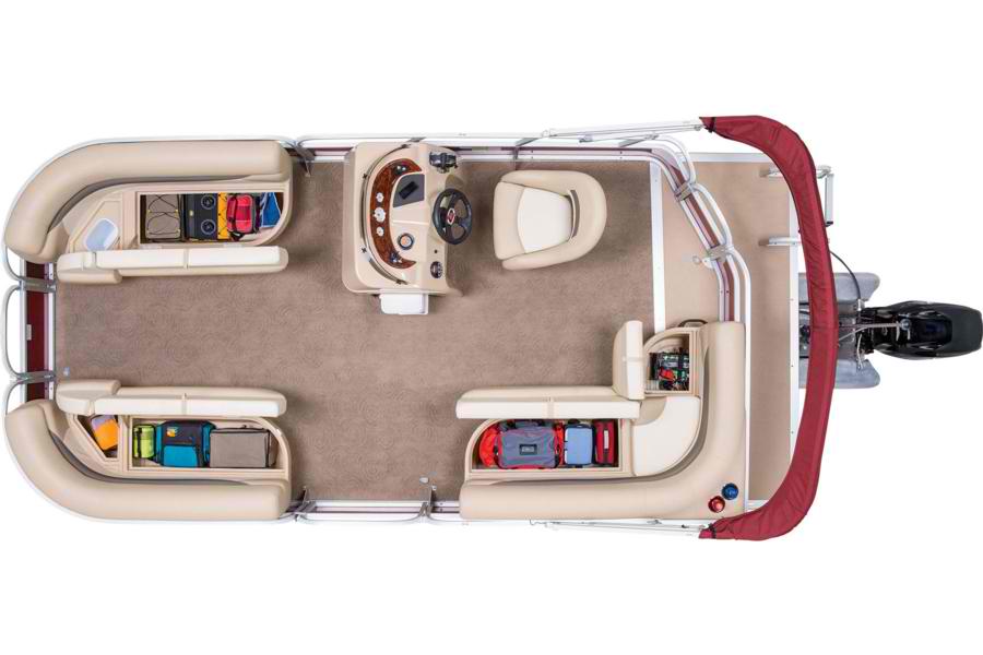

While I don't have any after pics to share what I did was to securely mount another cleat outside of my bow gate on the Starboard side just slightly off centerline so as to not be a toe kicker when using the front gate. I then used the bow corner under seat storage where an all but useless garbage bin was located. I keep an tri-lobe mushroom anchor and 100-foot line in there. I keep the line through the bit at all times so when I want to anchor I open the gate and seat and toss the line over the side then tie it off, then close gate and seat. There is nothing to get in the way or get tangled thus far....
