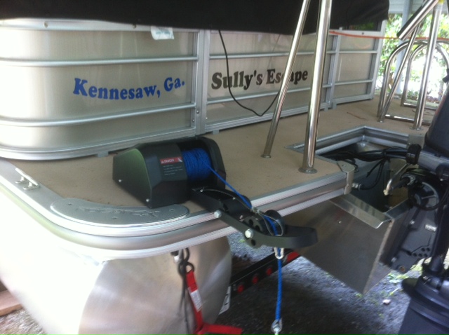

The rope looks to be about a 1/4". If so, do you think it is robust enough to use for an anchor? I use a 3/8" for my 20" Sweetwater. I always wondered that.

The anchor windlass set up comes with 100 feet of under 1/4 inch line (5 mm/.20") If you had to unsnag the anchor with any force, the line would snap. Unless you're anchoring at depth, you could probably replace it with 65' of 3/8" or even 50' of 1/2 inch.

Thanks BoatCop. I didn't realize it would accept an large diameter rope. I learned something new today so now I can curl up the in fetal position for the rest of the day and night waiting for spring.

I also have the Trac 35. Works great and comes with a remote control. Depends on where you boat as to what anchor, I boat mostly in a lake and anchor in coves, not deep at all, maybe 20 / 30 feet. I use a 20lb mushroom anchor with rope supplied have had no problems.
