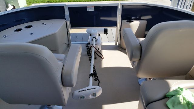

I also have an 80# 24V trolling motor. As mentioned, mount it on the bow. I bought the "quick release" base plate and highly recommend it. It's good to have the option of removing the trolling motor when you have guests on board and won't be fishing. The mount is lockable.mzodarg wrote:I have a 45" Ipilot 80# thrust,24V trolling motor, that I took off my previous boat (tracker TXW) I'm in the process of attempting to install it on the pontoon.
Being that it is a shorter shaft, I'm looking for ideas. I don't know if Minn kota will assist me in lengthening the shaft.
From the front deck I have 18" to the water so in theory I should have plenty of shaft in the water, I'm curious if others have done something similar and their results.
I've seen the thread on the automatic one under the deck but I'm open to other Ideas to include mounting it off the Transom.
Thanks in advance,
Mike
You won't have to lengthen the shaft of the motor.

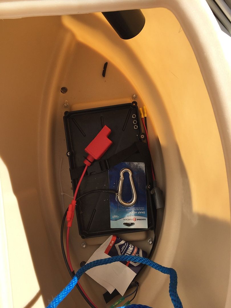

Had a chance to take a look at the trolling motor batter storage. It appears that I will have to come up with an alternative to what I currently have.
I'm open to ideas on battery storage for a 24v battery storage.

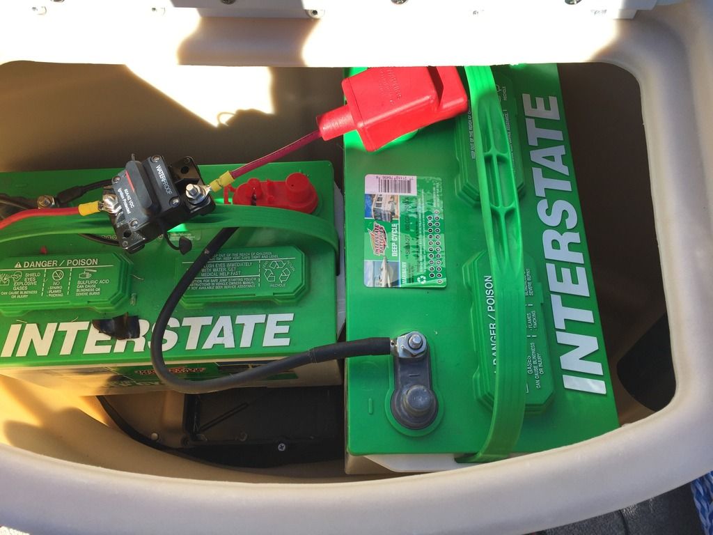

Re: 45" Inch ipilot trolling motor

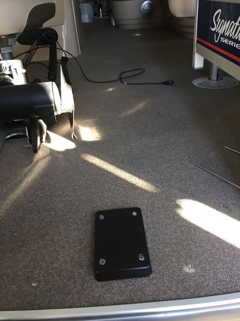

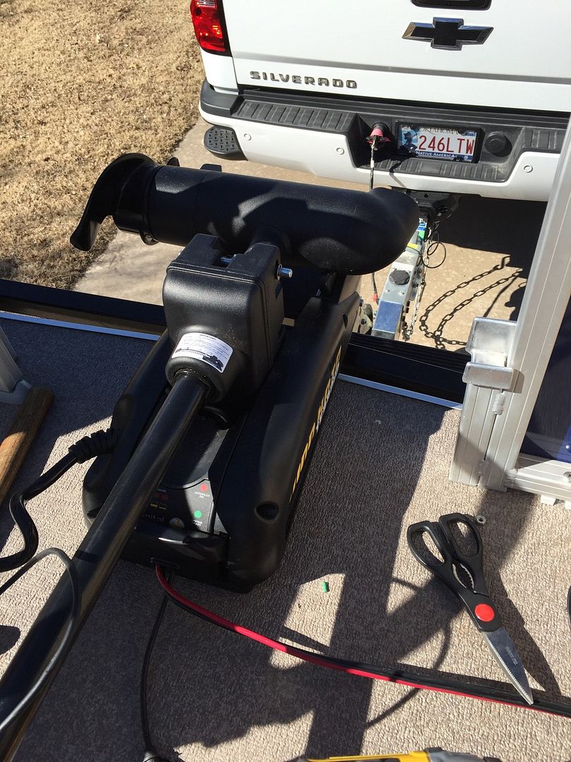

So there was no way to put 2 27 series batteries side by side, but this worked.
Also got the 80# IPilot mounted, I used the quick disconnect that was suggested here. Worked like a charm.
