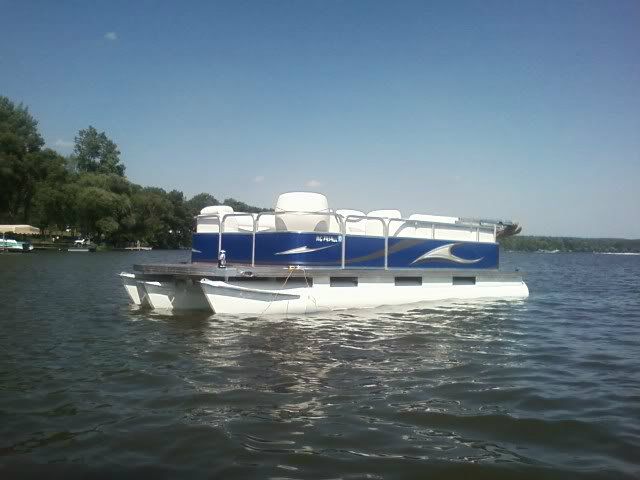

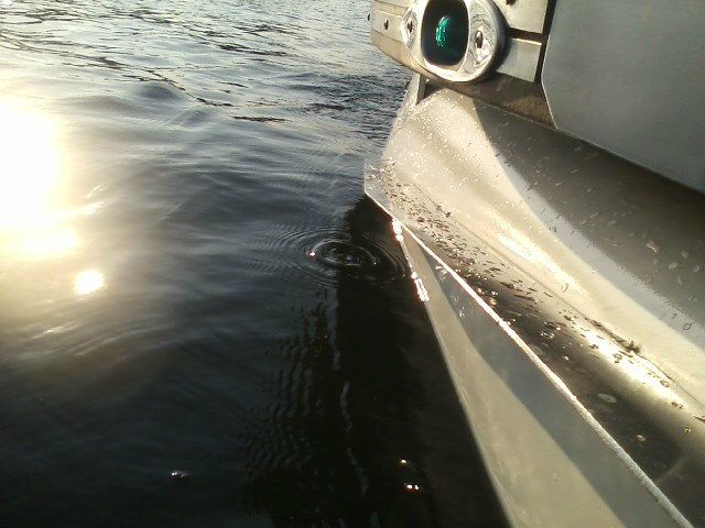

Soonertoon wrote:Any chance we could get some pics of that?
Just a few of the finished product. I'm having trouble finding any pics during the paint job.
