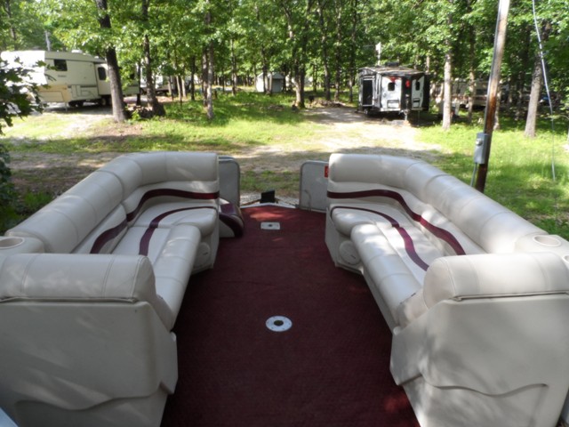

i found that it was cheaper with pontoonstuff and some others to buy new than to re-cover old stuff...plus what others mentioned about the wooden frames underneath rotting over time. Quality wise i have been pretty happy with the seats from pontoonstuff. i believe everything is made in china however. Overall i would give it a B+/A-. you will lose out on the perfect fit that your existing furniture gives you, but i haven't missed it. I did have the back deck reupholstered with a matching vinyl since there wasnt a premade item to buy for that. you can get pretty close with the arm rests and different seat size combinations. the vinyl seems quite nice, the steering/electrical console i bought isn't spectacular but it is functional. you buy everything in a kit with the plastic seat bases and seat padding separate and then you screw them together and install on your boat. pretty easy job.
- Posts: 5441
Re: Reface or replace?

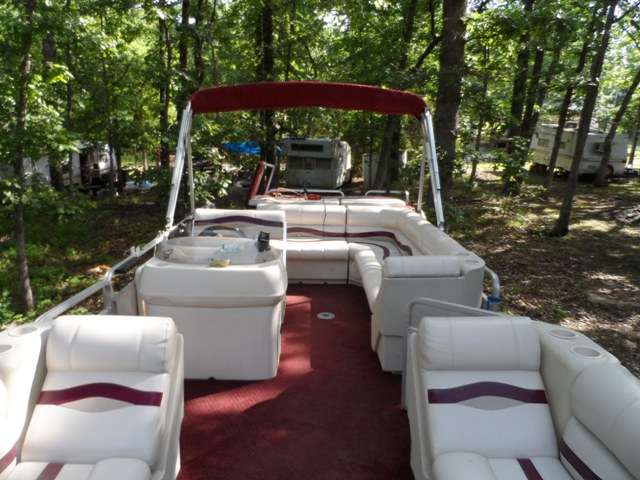

buy new from PS! You can place it however you want..
- SAM_5028.JPG (106.6 KiB) Viewed 7199 times
- SAM_5029.JPG (112.31 KiB) Viewed 7198 times
