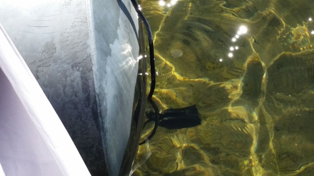

My new-to-me has the fish locator transducer bracket screwed to the little rib under the float. I don't think the lowest spot on the boat is ideal. I tired searching here for a solution and I found plenty of mentions about transducers bending, dragging, etc but no luck finding a fix.
The manual says to mount it in a non-turbulent location. Does such a place even exist on the rear of a pontoon?
No bracket:

I just wish the water I boated on was as clear as the water in that first picture!

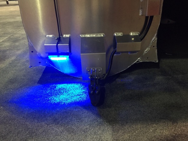

I saw this at a boat show. A place for everything. I read recently that you shouldn't mount the transducer on the port log due to turbulence from the prop.
