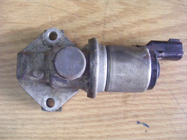

This is the picture of your IAC and it should be connected to your throttle body. Unplug and unbolt off throttle body and blast the crap out of it with carb cleaner. That having been said. Can you answer a few questions:
how old is the gas you're using?
When was the last time you used it and it ran OK?
Does it remain running if you keep throttle to it?
It sounds like a fuel starvation issue. Can you get hold of a portable gas tank and hook it up directly to the motor with fresh gas. If it runs good like that you can eliminate fuel, fuel tank and fuel line issues and start focusing on the motor.

Thanks for your reply. I have removed the IAC valve, I will clean it and try fresh gas tomorrow and post the result. Should I apply 12v to it to see if it moves?

You could. I don't think it's your valve if it wouldn't run with throttle put to it. Did the motor sit for a while?
