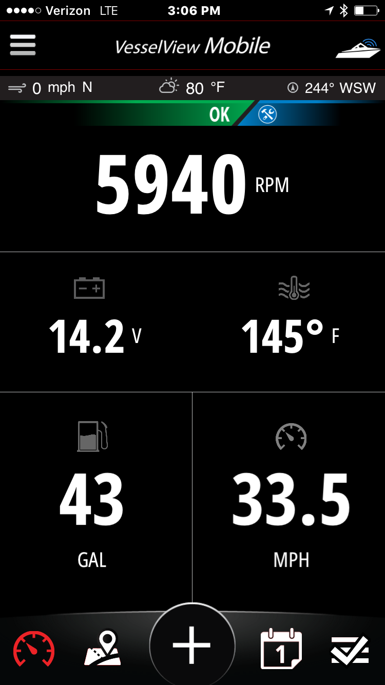

So, after reading this thread and doing a little research , I called Bass Pro and they had the Mercury Vesselview Mobile Monitor in stock. Sold. $275 plus tax.
Literally plug and play. Just find the 10-pin terminal under the cowl and follow the directions.
Went for a short run up the lake exploring the options on the app. Damn cool. Got the digital tach I've been wanting.

I need to spend more time with the Vesselview for a proper review.
Many of the features overlap with the Mercmonitor. Mercmonitor, being hardwired, will be more accurate. Vesselview is Bluetooth and loses contact flipping between apps or if you shut the engine down. Reconnecting is easy enough but fuel consumption could be off as a result.
One handy feature is, VV is very portable, so it would be easy to check another engine. The app alows four engine profiles. It will keep and maintain a service schedule.
