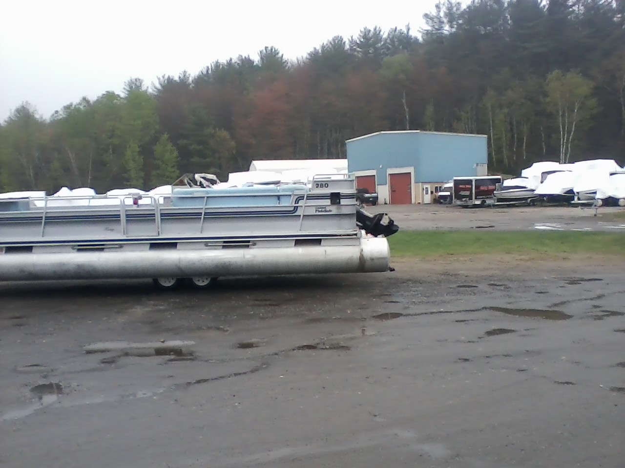

it's a 1991 one side has a fuel fill built in the other dosen't
- 0506170756a.jpg (185.47 KiB) Viewed 4928 times

Mine is a 1988 so not much different. I guess your best bet it to get under there and look. I would think with one filler it must fill and switch automatically. But it could have a manual switch over too.
Can you get in there where the filler neck and tanks are?
