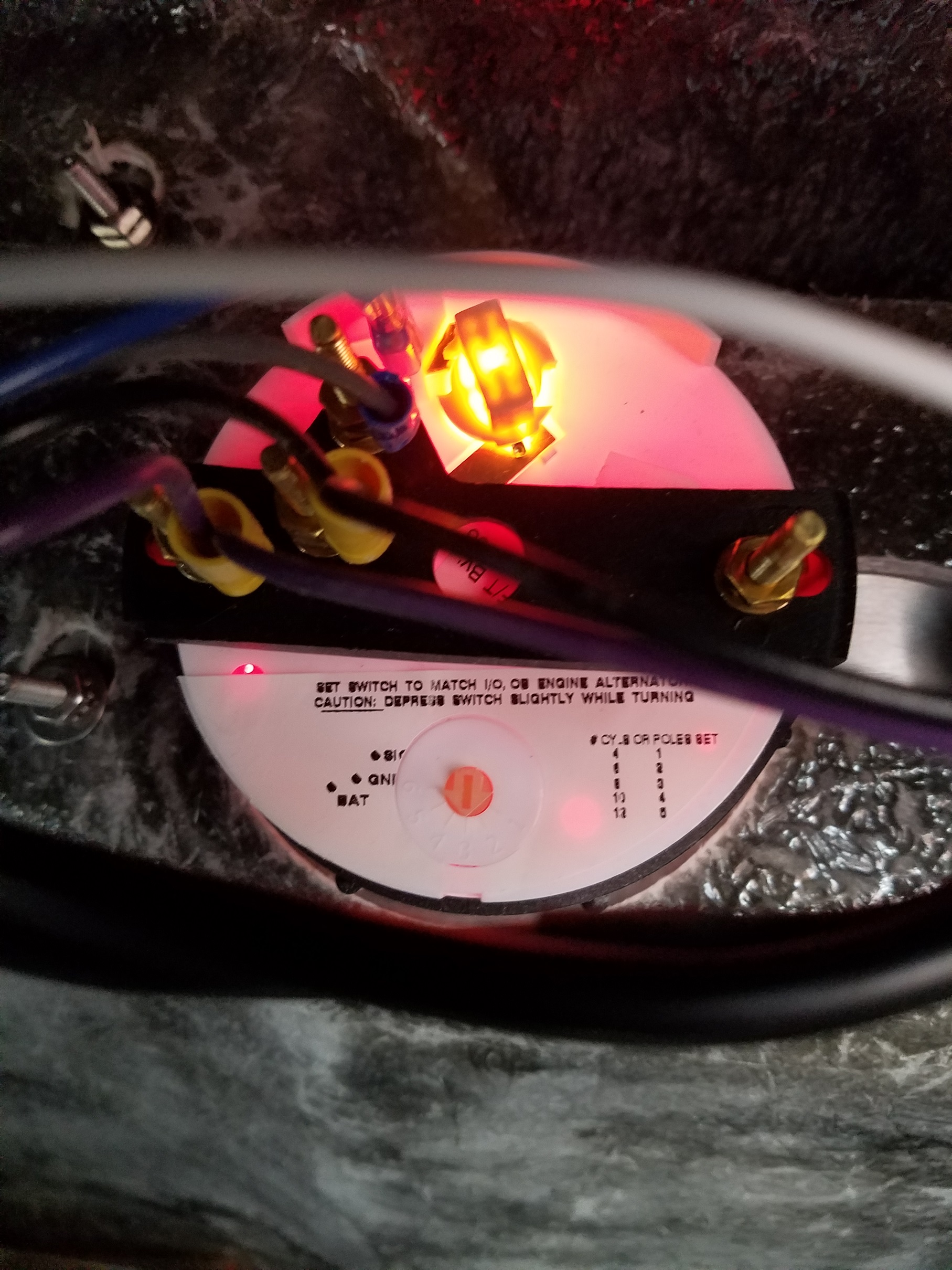

Hey guys, this is the back of my tach. I think it isn't set up correctly. I'm assuming that the Merc 150 is a 12 pole alternator. If it is, then this is definitely not set up correctly. I would assume all I have to do is set the back of the tach to 5, and I should be good to go.
I agree about a possible trip to the dealer. I don't think they did anything to set up the nav with the engine. I'll need to call them on Tuesday.

Isn't your 150 a four cylinder?
If so; it appears the switch should be set to "1."
The last tach I set for an outboard had a sliding switch on the back, and the setting was based on the number of cylinders.

I was reading that as poles on my alternator. So you're thinking that I need to set it to one, as my 150 in a 4 cylinder.
I'll give that a shot.

I think you were right with setting 5 for 12 poles.

Just about every outboard uses the "12 pole" setting.
Re: New Mercury 150 Four Stroke running high RPMs
Yep, setting 5 for 12 poles is correct!
