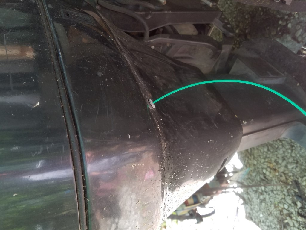

weedeater string! I keep some in my back bench. Mud-dobbers are notorious for clogging that.
- 20170513_132852 (Medium).jpg (164.85 KiB) Viewed 8547 times

we do the same as craig... the few times mine has gotten clogged with sand, we just kill the motor, and run weed eater line back and forth.. then restart the motor.. sometimes it takes 2 or 3 weed eater treatments to break it loose.
