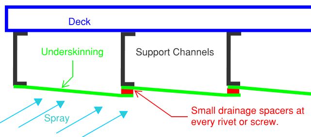

So does no one ever have issues, or even know if they do, with any water pooling up on top of the underskinning? If I was on freshwater I wouldn't be worried about it but saltwater pooling up there would be bad, especially if I use any stainless screws. Also in Florida where the dang humidity is 90% or better most of the year stuff doesn't evaporate very quickly!
Maybe my louvers description wast good. Here is a crude sketch of what I was thinking.

[quote="Jake_Daddy"]So does no one ever have issues, or even know if they do, with any water pooling up on top of the underskinning? If I was on freshwater I wouldn't be worried about it but saltwater pooling up there would be bad, especially if I use any stainless screws. Also in Florida where the dang humidity is 90% or better most of the year stuff doesn't evaporate very quickly!
Maybe my louvers description wast good. Here is a crude sketch of what I was thinking.[/quote]
I see no issues with that design, except possible "oil canning" noise if there is too much space between fasteners......... and a little extra work, but easier to handle smaller panels.
