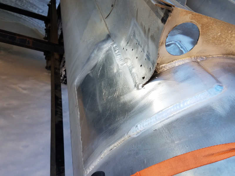

heres one reason to tilt the motor and use the support
the previous owner of my boat trailered it without supporting the lower unit, the bouncing on the transom did not hurt the transom but it did cause stress cracks where the mounts met the tube, i spent much time and effort repairing them.
so you are allowing a 300 lb plus motor just bounce up and down on the tubes, the metal fatigue will set in.
by using the motor support you eliminate a lot of stress,
i have been using a support under my motors for 35 plus years, never seen a supported motor get damaged, but i have seen an unsupported motor damage a boat or two.
these are the welds i had to use to repair my tubes from unsupported motor:
