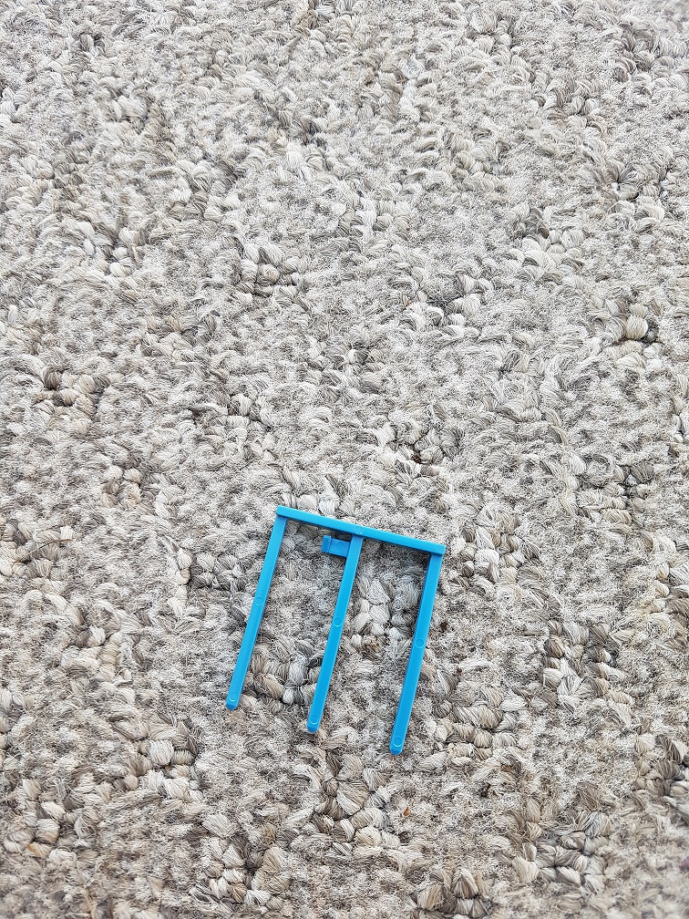

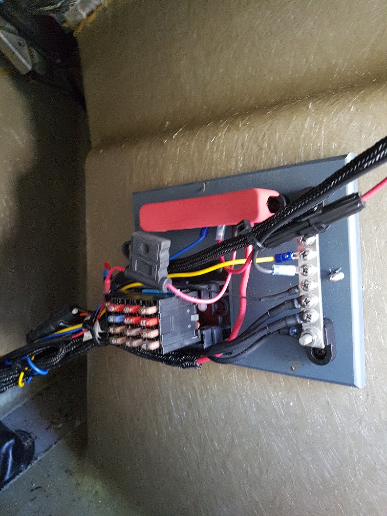

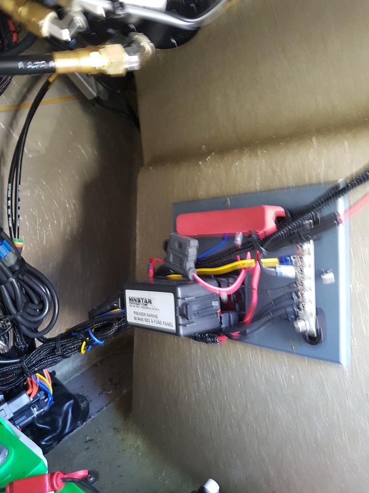

I've got a 2014 Premier Castaway that I'm hoping to add a few electronic goodies to. In looking at the fuse panel, I can figure out how to take the cover off, and there's a three prong clasp that comes out fairly easily. I can't seem to figure out how to release the panel to be able to wire into the back side of it, however.
Anyone done any playing with their premier fuse panel and have some experiential advice?
All wisdom appreciated!

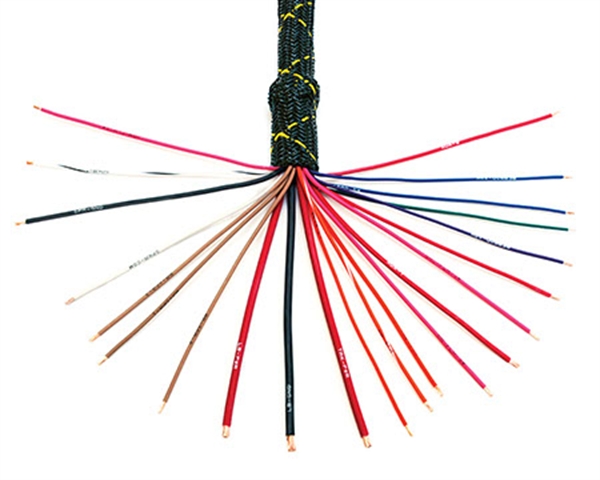

When I was wiring in stuff in my old Premier, I found 4 unused (non power fed, yet) hot wires in the wiring harness. I tapped into those, found where to put the fuse to fire them up and was set. I thought it looked like it would separate by gently prying the 2 halves apart, when I took out the plastic retainer, but then I saw the empty fuse slots and figured since it was all pre-wired, it had to have unfed wires. Here's a pic I found. The wires were in the end of the pigtail.
Hope the case is the same with you. It made it super easy.

Exactly!!! No need to feed a new hot wire into the fuse panel because one of the fuses spade ends is already hot. Find the wire that is connected to the other side of the spade, where the fuse goes, then installing the fuse, will complete your positive circuit. Find the loose wire coiled in the harness, pick one and put a test light on it, then put a fuse into the empty slots. Some of the wires are
'Keyed" hot, so you will need to turn the ignition key to the accessory position. Or turn on the accessory switch, which was how my Premier, was. When the test light lights, you found that wires fuse. If I remember correctly, I had a few 10, 15 and 20 amp empty fuse locations, and the wires were different gauges, that went to the 10,15 and 20 amp fuse locations in the fuse box, so that helped sort out the wires, too. The bigger the wire, the larger amp the fuse that feeds it.
Like I always say, if you guys lived closer to me, I would love to help.
