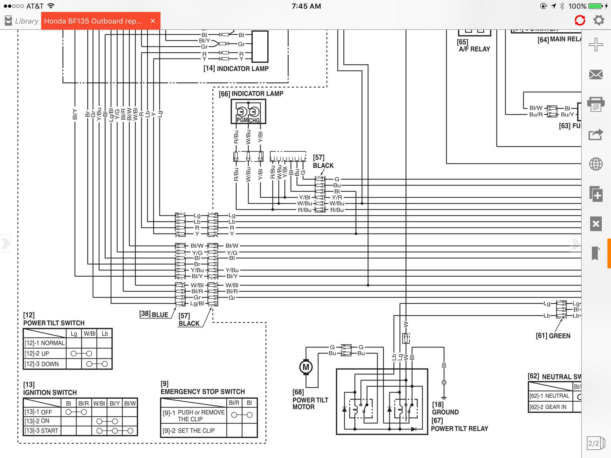

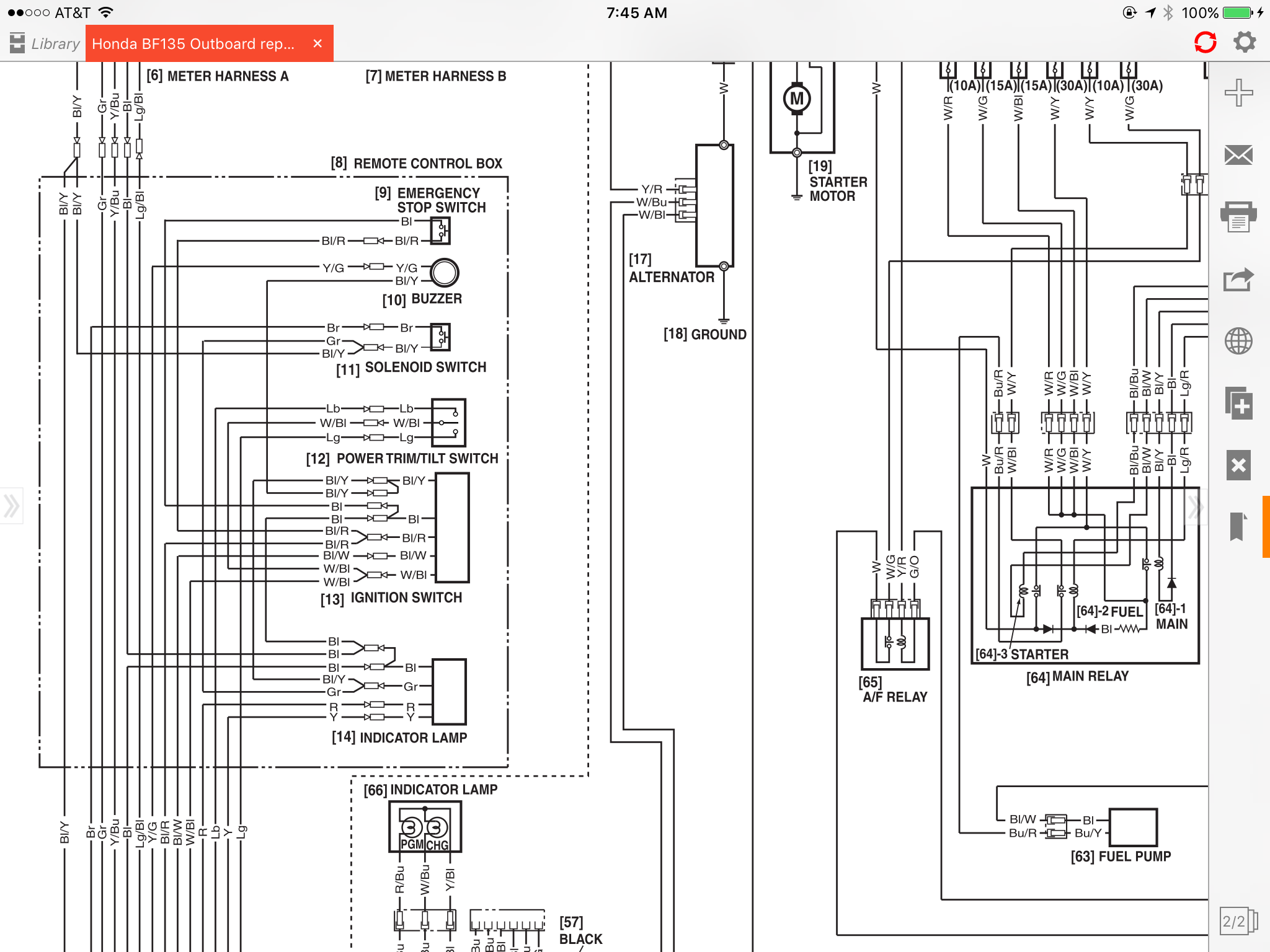

#2 Post by TDJ2591 » Tue Aug 15, 2017 5:48 am
I don't know if this will be of any help to you but here's the wiring diagram for the switch on my Honda.

#3 Post by sunedog » Wed Aug 16, 2017 5:07 am
Thank you so much for taking the time to post that. It basically validates what I have. All the wire colors on the diagram for the ignition switch section match what I have. Unfortunately, it still doesn't help me figure out which wire goes to which terminal on the new keyswitch.
