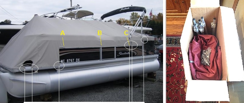

I am literally in the same boat you are. (no pun intended)
The cover on my 2013 Sweetwater 2286 was torn in a windstorm. I was able to have it repaired (temporary) but ordered a new cover direct from Godfrey.
It came with the snaps in a bag...for me to install. My intention is to install them when I take the boat out of the water for the winter. That way I can walk all the way around the boat.
Here is how I intend to do it. (as was stated by others, I'm sure there are other ways, but this is the way I have chosen to tackle the job)
I have already installed the snaps in the areas that I consider "constants." The attached picture is not my boat, but it illustrates where I have installed snaps (white circles). These are the places, "corners" if you will, that can really only be installed in one place. This will be enough to hold the cover in place, with the poles installed loosely, while I mark the other exact snap locations. As I work my way around the boat, I will install snaps in the middle of the long stretches (B), say between snap A and snap C. I will do this on both sides until all the snaps are filled in.
Hope that all makes sense, I hope it works, and I hope it helps.
