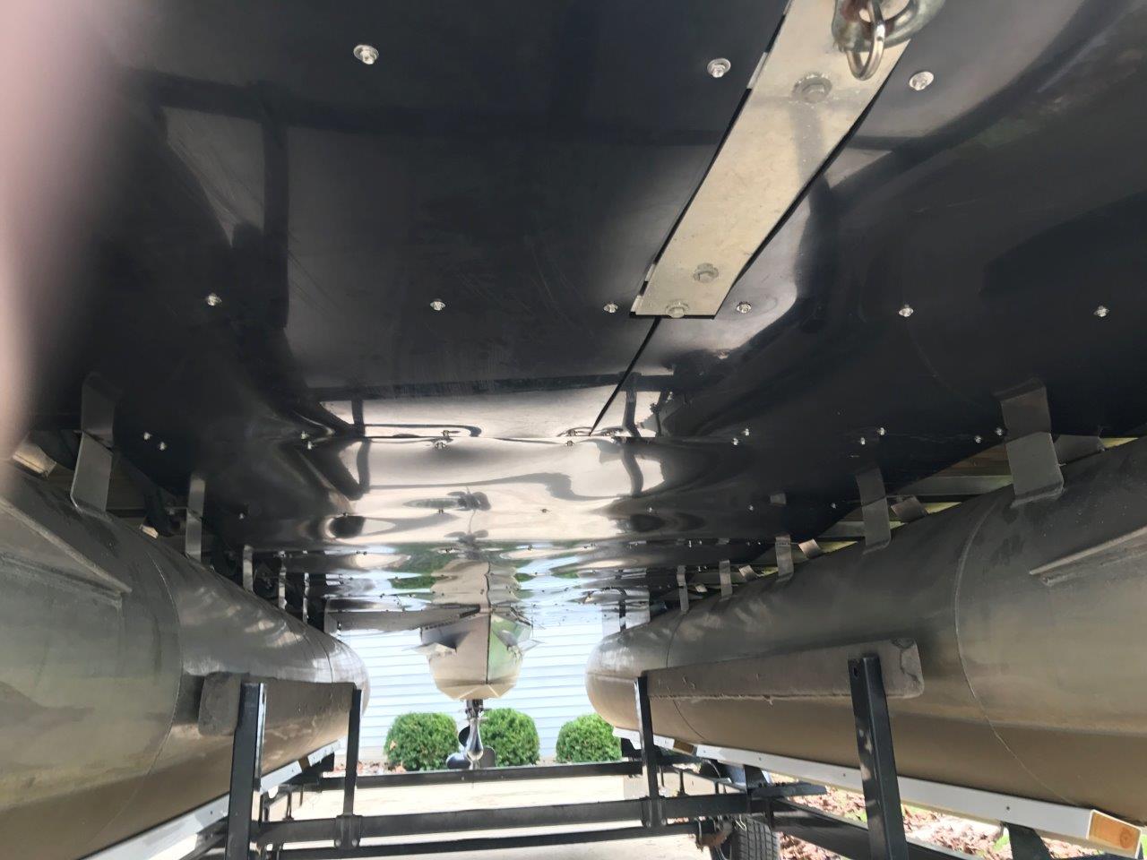

So before I get chastised for not conforming to the group suggestion of using aluminum for underskinning...well. I like to be different. I actually talked with another member on here that used sheets of 1/8" hdpe plastic as underskinning and he's been very happy with it. In his situation, he routinely has asian carp that fly out under the boat and having a 10lb fish banging on aluminum underskinning would have been a pretty sad sight. So for my 20' I used 4 sheets of 4x8 that I ordered from a local menards. It was $142 for the sheets, which was less than half of what I was finding locally for the aluminum. I used #10x3/4" self tapping stainless screws with 1/4" stainless washers. If the screws start working their way out, I can always take them out and drill out for a rivet. I predrilled the holes for the screws because the drill bit went in a lot faster than the one that comes on the screws. So far it looks good. I was actually going to winterize the boat and already cleaned it and put in the mothballs and dryer sheets, but of course, this weekend it's supposed to be 90. So maybe I'll take her out and see how it performs. One thing is for sure. This stuff is tough! It won't break, but will bend. Even the small scraps that I tried to break will only bend and kink if you step on them. I think for impact resistance this would outperform aluminum. A full sheet I believe weighs 40lbs, and I used 2/3 of a sheet because the distance between the toons were 5'. So I cut it down with a circular saw to 4'x5' pieces. I'm guessing it added about 120lbs of weight. I would guess it's more than aluminum, but not a crazy amount.

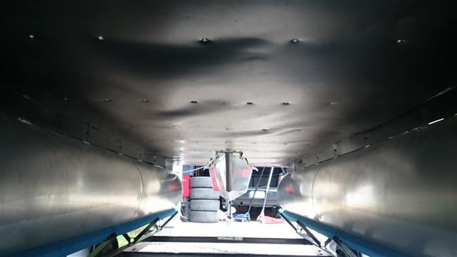

Re: HDPE Underskinning
same material for 3 years

I actually did. I used 1/4" washers for #10 screws.

And if anybody ever tells you to go ahead and do this, and "it's easy". They are lying !! I had the boat on a bunk trailer, so I had about 5' underneath it to work with. I used stands to hold up the sheets while screwing them in. It was in my driveway so I had all the tools I needed, and I precut the sheets to 4'x5' to fit between the bunks and line up on the beams. It was still a giant pain in the butt!
