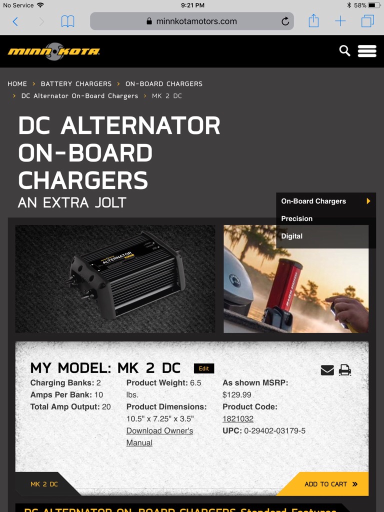

Here’s an email camp,e of an on board DC Charger I’m looking at. I hope someone has one that can advise on its performance.

Thanks Craig. I first heard of these years ago being used in bass boats to charge TM batteries. Websites also recommend them for pontoon boats. Any boat with secondary batteries should benefit from it, but how much is the question. Someone must have them...

Steve, I think I will be good with the DC Alternator, with the occasional use of a 2000 W Honda generator. Like Retired OG, I am not on the TM much when I do use it, and will vary my boat motor usage with short and longer trips, hopefully keeping the batteries fairly high.

I'm also aware of those chargers but my knee jerk opinion is that there is just not enough run time on the main engine to charge if the troll batts are used much (how much is much ??) Some of the really smart guys can use the formulas about all the watts, amps, amp hours and so on to get a better idea. What caught my attention is your use of the 24s and not 27s. I'm in the process of installing now and have been debating 24 vs 27. The 2 27s will only add another 8 lbs and a few more bucks. How the 24s working for you?? I will be using one of the smaller 24v motors (68 lb)

A typical Group 24 is rated around 75-85 amp hours.
A group 27 jumps to 95 to 105 ah.
Those ratings are based on draining the battery slowly from full to empty over 20 hours.
If you pull all of the power from the battery in something like 4-5 hours, you will get about 20% less. That's just the nature of the beast for flooded, gel and AGM batteries.
If your 80 ah was only drained by 20%, that would be about 16 amp hours. If your alternator can provide 20 amps to the trolling batteries, then a 50-60 minute run would be required to charge the battery. If you drained out half of the battery capacity, you would need a bit over 2 hours of running, etc. Keep in mind that some of the 35 amps from the alternator is required to run the engine!
My little 115 HP Yamaha can only produce about 15 amps of 12v DC. I have very, very large trolling motor batteries, so a shore charger is used. BUT, the alternator keeps them topped off while not being used. For remote use away from my dock, my Honda 2000 drives my 60 amp charger with ease.
